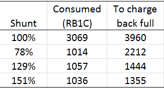

I have a question regarding calibrating the shunt parameter. I'm running a Spirit Pro, HW 160A V4, FrSky Horus and OpenTx, all at the latest versions.
To calibrate the telemetry current consumed with the charger (icharger 4010 duo), I performed a series of hover flights with different shunt values:
I'm clearly approaching this wrong. How do you calibrate this shunt parameter so RB1C is accurate?

I ran a few more hovering tests with the shunt parameter set to 95%. I tried this value because I read where a few others had found this to work with the HW ESC. My results
Test, consumed in flight, charge back full
1, 1060, 1847
2, 1050, 1815
3, 1043, 1490
4, 1059, 1535
Test 1 was with only the signal wire routed to the Spirit. In test 2, I computed the consumed current myself from RB1A (in the Horus radio) and got the exact same value as RB1C. In test 3, I ran the signal and ground to the Spirit...and it got a little better but still not close. In test 4, I ran signal and ground to the Spirit but twisted the wires and routed them on the other side of the heli away from all other wires. No significant difference.
I'm suspecting my HW is way out of calibration, but it's strange because it seems to be working for others. Maybe I just got a bad one?
Posts: 13047
it looks like the ratio is changing little bit so the question is what is reporting the current (capacity) measurement more precise.
But for your setup it looks like good ratio could be 190%.
