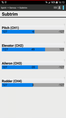

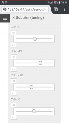

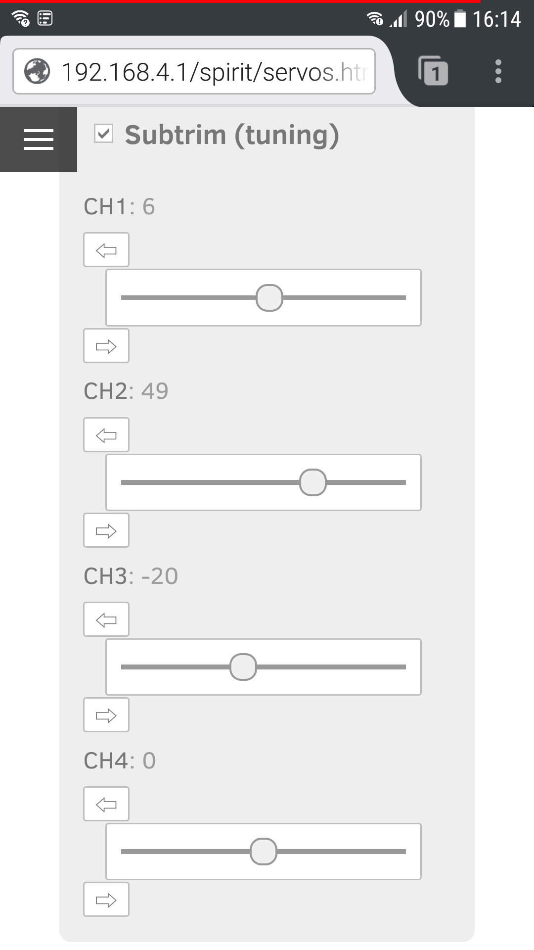

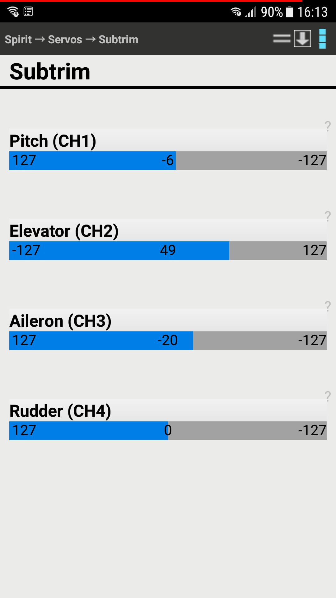

I see but, thats not what I meant. Let me see if I can illustrate what I mean (see attached pictures):
Same heli, no setting changes between the two pictures (App vs. Browser).
CH1, 3 and 4 are reversed, CH2 is normal, as the scale in the App indicates correctly.
However, CH1 reads 6 (+6) in the Browser but it should be -6 as in the App.
In both cases the graph indicates a value to the right of the center (corresponding to CH1-servo up, ok). In both cases the CH1-servo goes up as the value is “increased to the right”, and down to the left. Ok. But the APP vs. Browser values for CH1 show different sings.
This is what I find confusing. And since the value of CH3, which is also reversed, is identical in the App and Browser, the “lost” minus in the Browser (and HoTT) with CH1 seems to be a bug.
