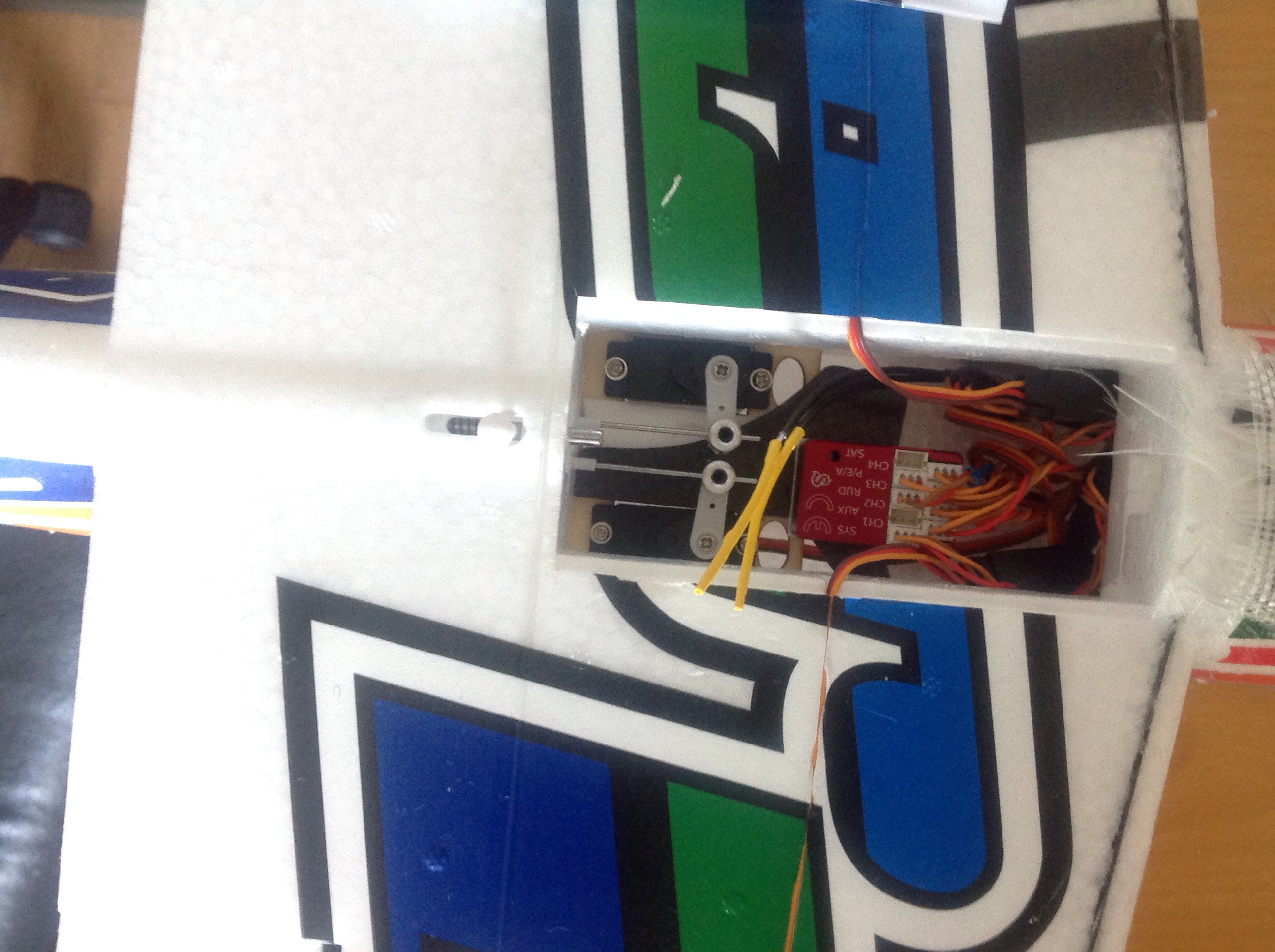

Just ordered a uSpirit that I intend to flash with the aero fw directly on arrival to go ina HyperBipe first but will end up in a PA Ultimate. I have only found 1 vid on YT and NO flying reports hardly yet so I will try my best to report!

Got everything set up, Test flight will be asap!

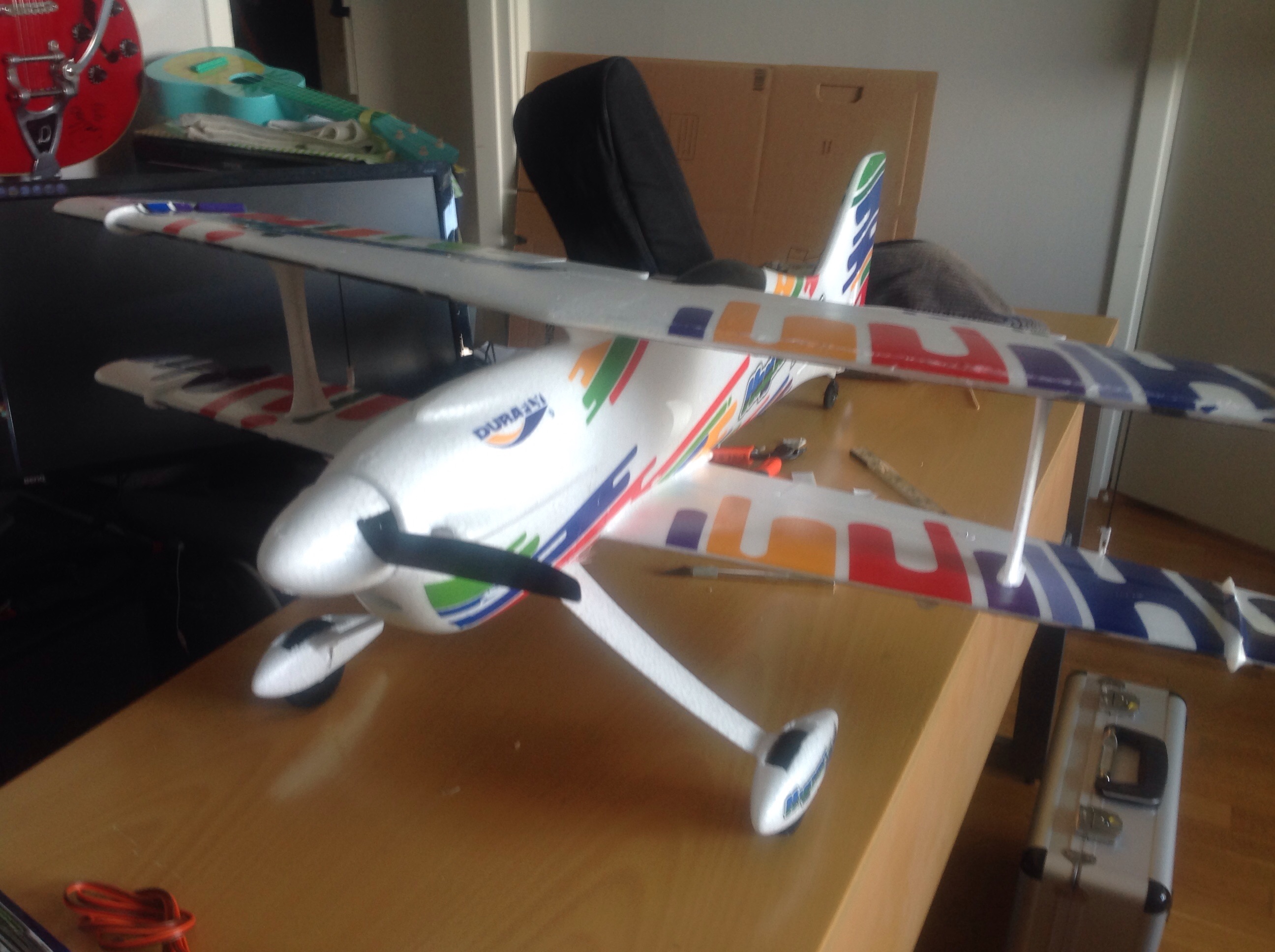

Maidened, two packs and my initial feel is that the uSpirit with aero fw 1.2 works marvelously. 50% global gyro gain, no oscillations on any axis, rescue works perfectly! Will tune for max gain and guage for improved performance. This little foamie flew amazing despite gusty conditions. I could see the gyro fighting sidewind gusts kung fu style at 50%. Hovered almost hands off. A bit of coupling towards the lg in knife edge about the only thing I noticed. I wonder if a little mix can help with that? Getting ultimate precision in mounting the uSpirit 100% accurate proved a challenge and I am not entirely sure I got it totally right but the spirit worked amazing!

A couple more flights. I noticed I missed maxing out my limits in the config but now have nice rates. A little rudder to elevator mix took care of the coupling on the plane. The uSpirit is awesome, dying to get a PA Ultimate AMR to put it in.
