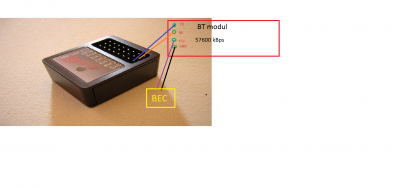

For the bluetooth support can you please let me know exactly where each pin is supposed to go?
The TXD, RXD, GRND, and VCC pins go?
Also, is there polarity protection on this unit? If the power is accidently plugged in backwards will it destroy the unit?
Finally, is it possible to run Bluetooth, 2 Sat Rx's and the signal wire for the Gov once that is available?
If not it is not an issue as I can disconnect bluetooth after fine tuning of the system is done, but just curious. I will most certainly like to run the Gov once available and 2 Sat Rx's for safety.

Remember, it is necessary to set 57600 baud rate, then it should work with all BT modules.
Yes, there is a polarity protection.
Just be carefull with SYS and AIL/PIT/ELE connectors, it is not supposed for power supply.
It should be possible to run all peripherals in same time, but I can't tell you more at this time.

Here is the picture of connection.. It´s very simple and full work with any BT unit.. It important settings speed of connection if dosen´t work..
Posts: 12920
Good job! Thanks :)
I will post official scheme as soon as possible too into new Bluetooth thread.
