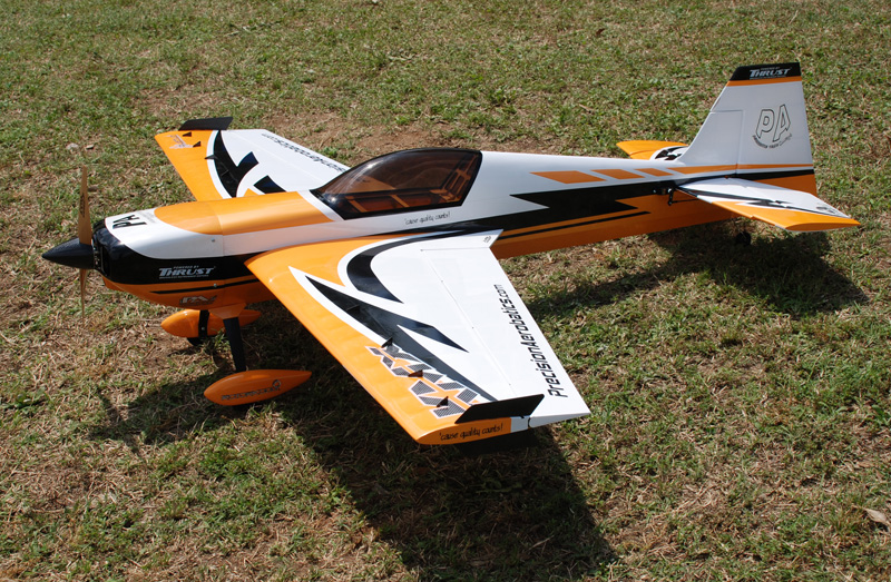

I now have 35 flights with a uSpirit in a HyperBipe foamie and 4 flights with a SpiritPro in a PA KMX. I have another 54 earlier flights with a Aura8 gyro in the KMX and am so quite well aquainted with it. Flew 2 flights each with both this evening and it was quite windy but both planes coped wonderfully. My last prior, longer outing was with dead calm weather all day and I had an absolute blast. The Aura was still in the KMX at that time and comparing basic performance there is no difference between the gyros that I could tell directly. I do on the other hand feel that the heading hold mode of the Spirit is doing something! I need to get the KMX out in calm weather for a good couple of flights to see if I can pin point what I am feeling. Will definitely try to get some footage. Small planes have never been this much fun!!

It looks just awesome!
Very nice photos and especially models
Thank you for keeping us updated!
