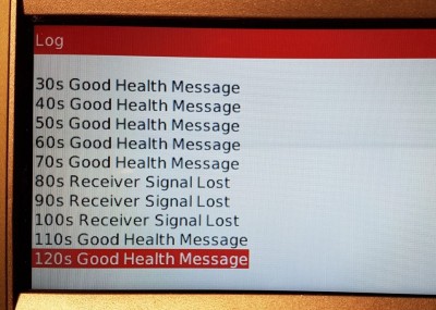

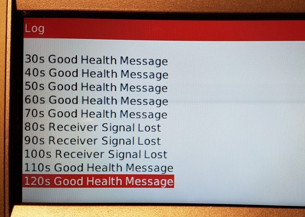

Wow this was fast. I did test, but still not working. Log shows: Receiver Signal lost.
I can force this lost, 3 out of 5 times, if I go into basic and switch Banks.
If afterwards I go into Logview and do a readout of "previous" till the end, exit and power off, Log is not cleared "previous" is still there.
To get clearance of Log, I need to go into Logview, readout "previous" exit script reopen it to read out "current" and power off and only than, log is cleared.
But during this 2nd readout, on listing the 1st log line, Signal gets lost, causing a log save, which forces me to restart the clearing process again. It might take up to 10 reboots to clear the log.
