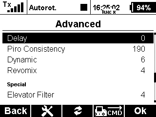

I enjoy the Jeti radio integration, but I feel it has room for improvement. When I make parameters changes using the Jeti radio, the current bank is not obvious in the display. This Jeti screen shot does not show the current bank anywhere on the display.
Spirit - Jeti Integ.jpg (42.11 KiB) Viewed 6766 times

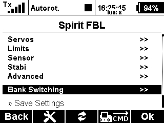

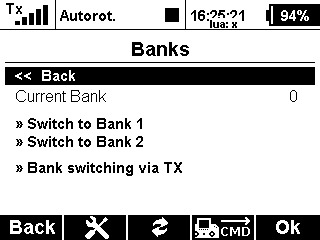

One has to go into the Bank Switching Menu to determine the Current Bank. I feel this is very cumbersome.
Spirit-Jeti Bank Swit.jpg (43.23 KiB) Viewed 6766 times
Spirit-Jeti Current Bank.jpg (41.89 KiB) Viewed 6766 times

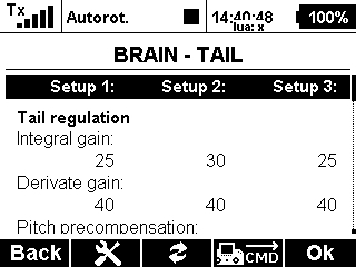

The Jeti integration also does not currently have a way to compare the bank values as in the regular Mac/PC software. I consider this bank comparison very important, and one of the reason I still bring my laptop to the field.
Please consider improving the Jeti integration display so that it becomes obvious which is the current bank I am making value adjustments/changes, and a way to compare the values in all three banks. This is a Jeti screen shot of Brain2 integration. Notice how this GUI displays the banks (Brain2 calls them setups) and allow for comparison of banks/setups values in an "easy to see" fashion.
Brain Integ columns.jpg (49.47 KiB) Viewed 6764 times

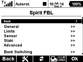

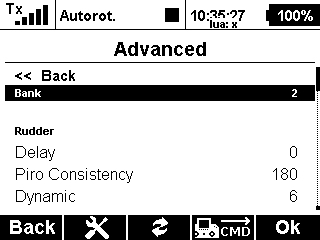

Current Bank is visible through the menus.
For closing the integration menu there is entry "Close the menu".
This replaced also the entry "Bank Switching via Tx".
Re: Jeti radio integration improvements
Posted: Wed 04. Oct 2017 15:58:09
by curmudgeon
Very good and much welcomed improvement.

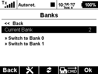

The Bank number is now on the top of each menu and sub-menus.
This is how the new Bank switching screen looks like.
I would like to have the option to visually compare Banks (column format seems to work well) and ideally allow for parameter editing in that comparison screen (as opposed to just being an uneditable, visually comparison only screen)
