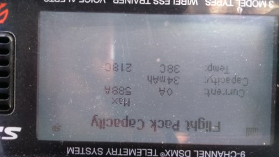

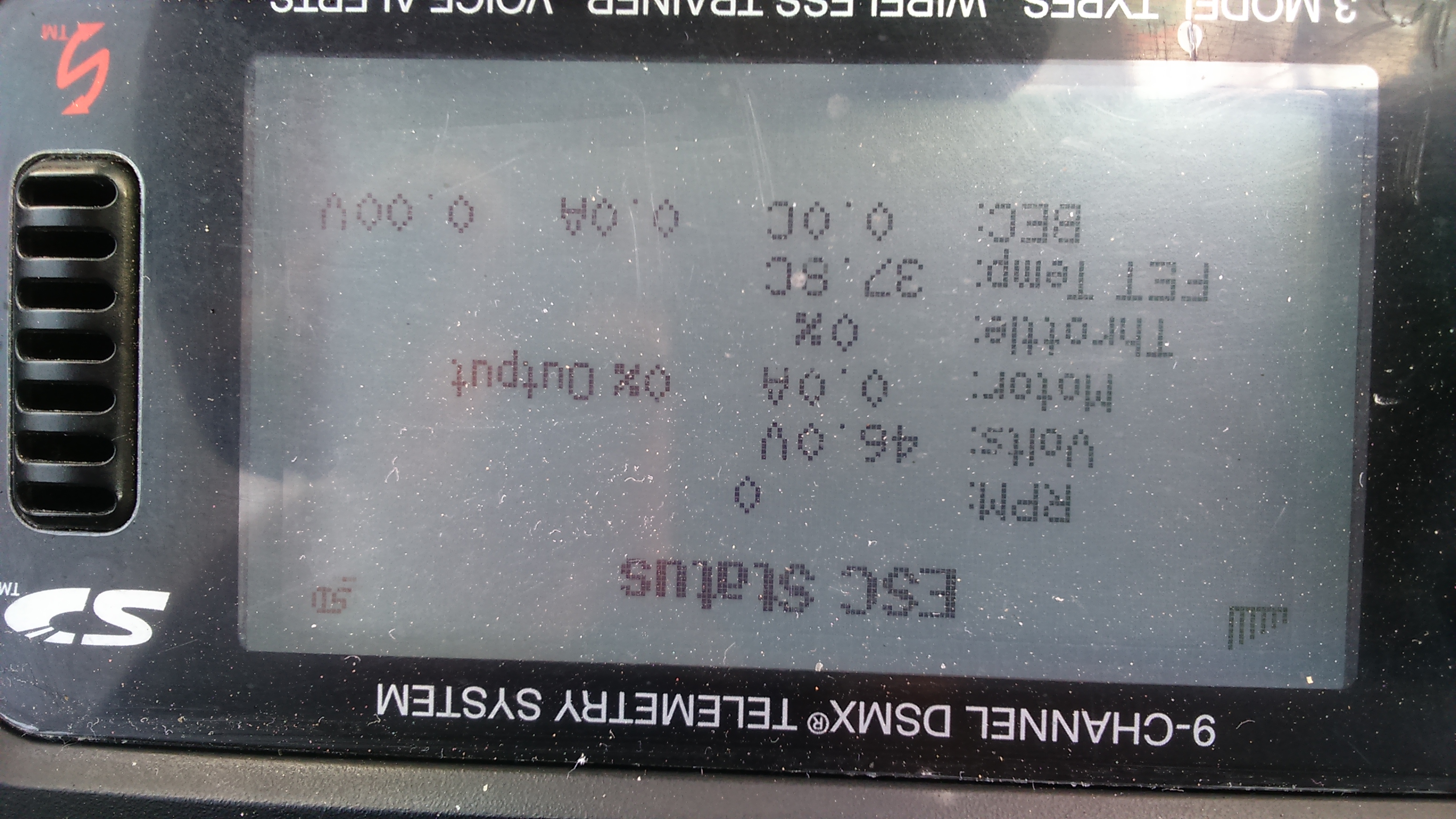

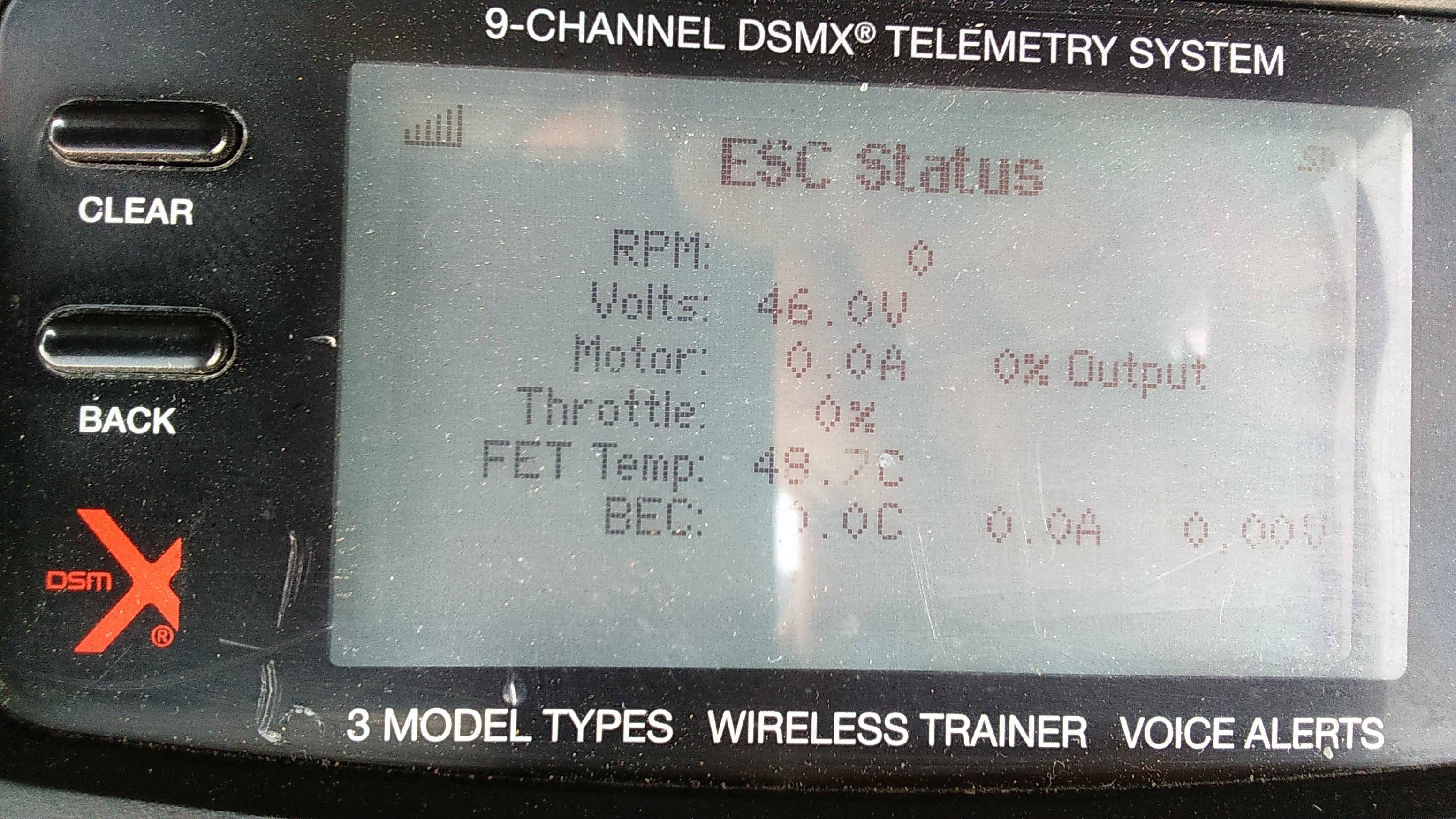

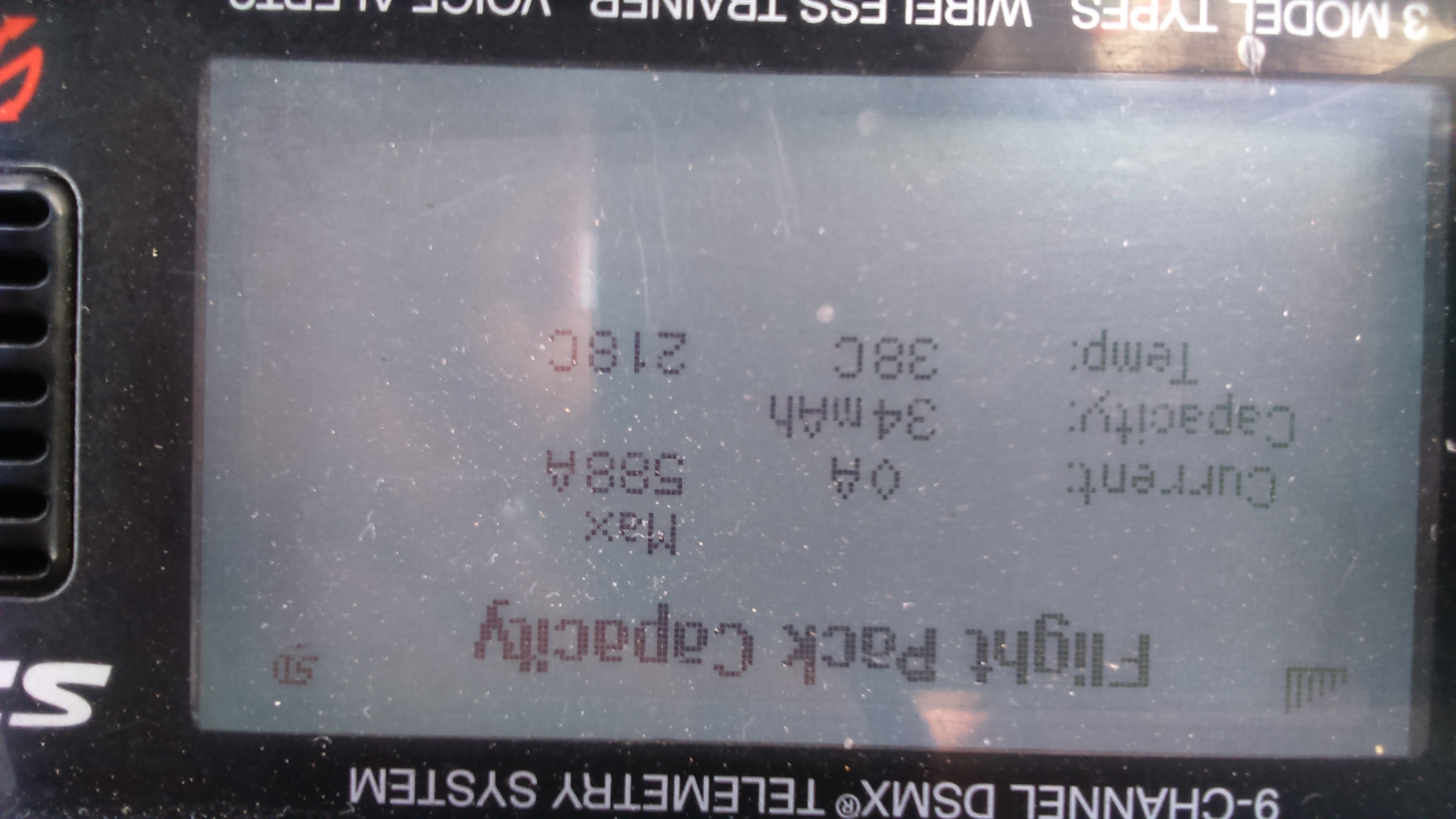

Hi, managed to get two flights in this morning. Results not what I expected. TX Telemetry screenshots attached.
Packs are 2 x 6S 5000maH. Starting at 4.208V per cell and landing at 3.86V. First flight took 2050maH and 2nd took 2158maH out of the batts.
HW telemetry ( for what it is worth...)
Flight # 1 : MOS Temp 35C 42V 135A
Flight # 2 : MOS Temp 35C 40V 154A
I do see the correct RPM during spool up.
What is wrong with my setup please ?

Posts: 12863
Hello!
Thanks for the photos.
The values are off quite a lot.
What could be wrong is I-motor Shunt value - is it at 100%?
Or the telemetry connection (Telem UNI) is somehow not stable. Can you verify the cable please?
Are you able to save the flight log and view the plot to see how the values were coming from the unit?

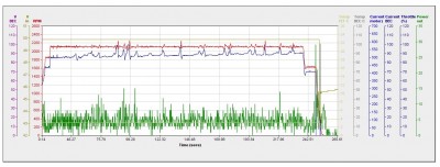

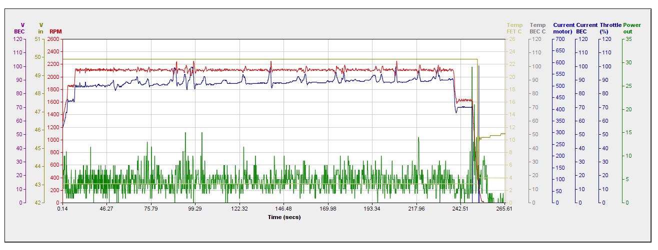

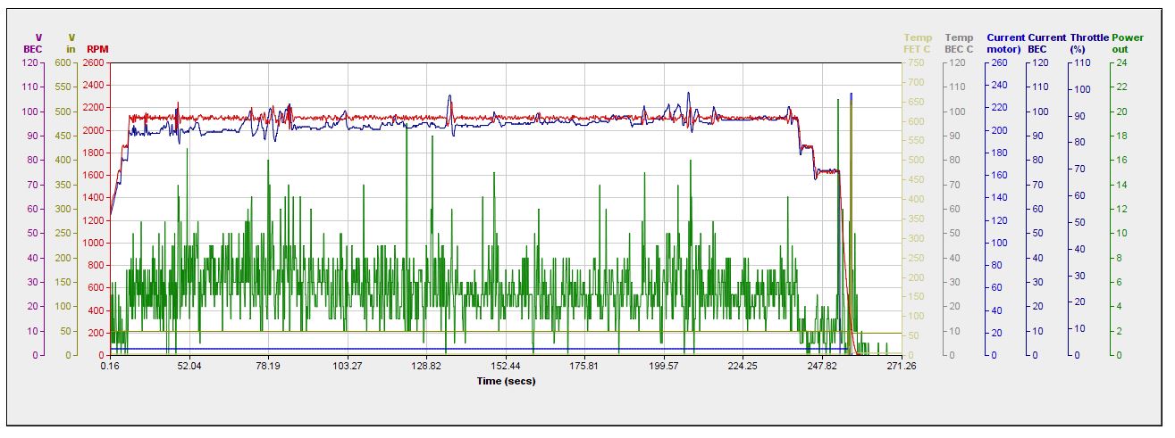

Edit : Attached are the two graphs and the TLM file.

Posts: 12863
Thank you for the details.
Could you please post just the Current plot?
As far as I know the only issue that could be responsible for this is bad connection of Telem UNI cable.
Unfortunately it looks like there are more HW v4 200 units that are reporting some data (especially current) incorrectly. So if you are sure that the telemetry connection is correct, then it could be such problem. Maybe it could be fixed by HW firmware update - please check your version.
We will find from your plot how stable is the reading and then we will know what the problem is.

Hi, unfortunately I lost the source files. I will put a few flights through it to create new data.
