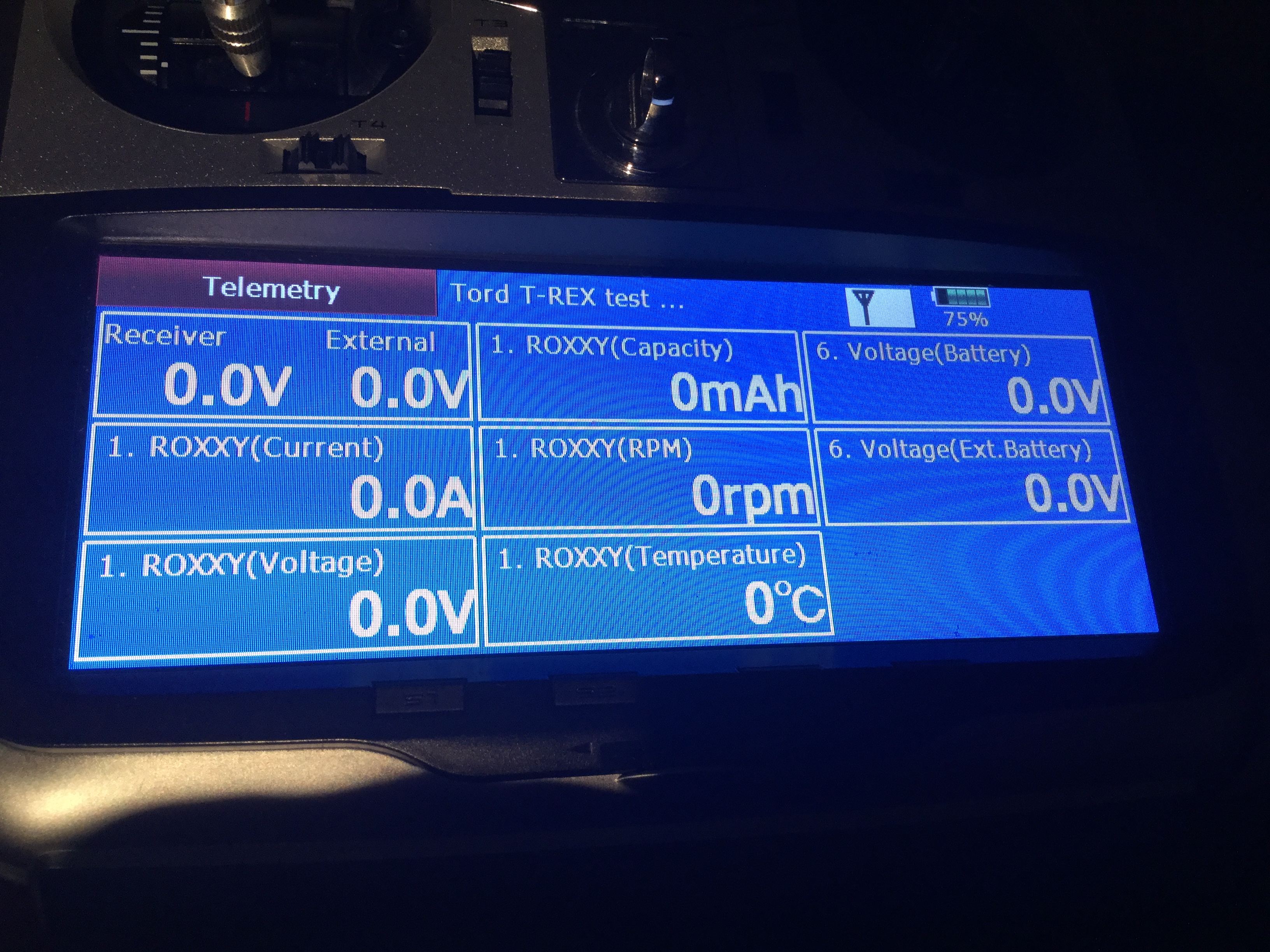

I've got my frsky cable and wired as online manual describe, Black and Signal on RUD port. Red to Tail pin.
Shorter wire to 7008sb Sbus2 port. Ch0 for external supply from receiver.
I don't see any ROXXY ESC in 18sz Menu.
Any advice?

That's the problem. I can't seem to find ROXXY ESC in sensor menu items of 18sz (firmware 3.0E)
I clicked all of the 3 page items and No ROXXY ESC.
sensor type slot 8 / 16 / 24 have multiple of items including Castle TL0, Kontronik ESC, Curr. F1678, Vario-F1712 etc.
But No ROXXY ESC.

Probably transmitter update will help. It is also possible that they renamed it from ROXXY to other name.

I'm pretty sure it's not there yet.
It's supposed to be between Current sensor and Kontronik ESC but it's not there.
14SG and 18MZ has it. (not sure 16sz)
But not 18sz...

As far as I have found the ROXXY ESC should be present in the older firmwares as ESC.
It is strange they have removed it just from this yet there will be also still users with these ESCs.
You can try to reset telemetry data. Maybe it will be automatically detected.
