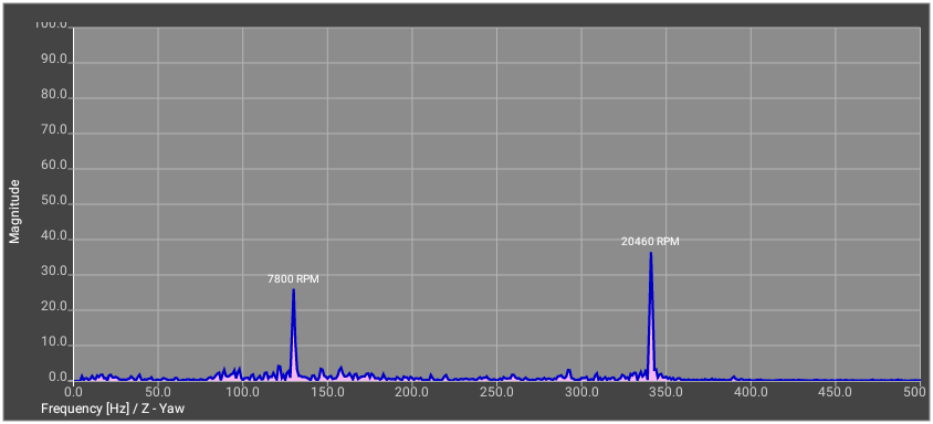

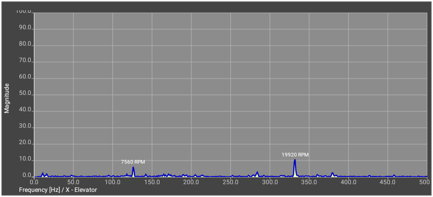

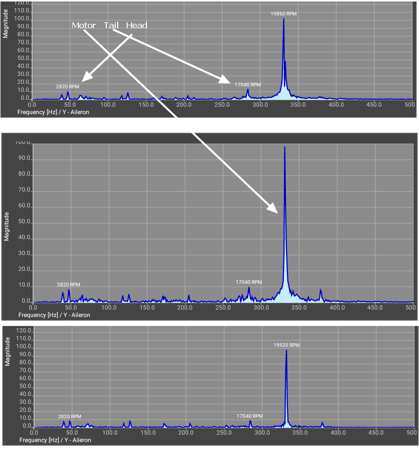

I have tried swapping the tail assemblies, new tail belts, etc. I'm currently setup with a long-boom and 550mm Align CF blades. I removed the blades and did the vibration analysis and saved the plots (see attached). The X and Z snapshot images looked about the same, so I only show one. The Y was more dramatic so all three are shown along with some arrows pointing to items that I think are the motor, tail and head.
The Y axis (yy.png) seems like the problem. Is this showing me that I need to motor bearings? What should be my next change before re-running the test?

from the plots I can tell, that the only problem is motor.
It looks like a bent shaft or faulty bearing.
To be perfectly sure, move the motor from the main gear or unscrew the pinion and then spin up the motor.
If the spike will be still present, then it is for sure.
Other spikes are OK.
