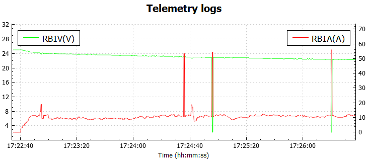

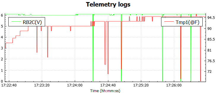

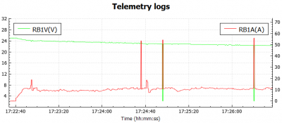

These four telemetry variables all showed blips. The other variables had no blips. Some occur at the same time, other do not.
Posts: 13048
since the question was answered just in PM, I will answer here too.
The problem is caused by limits of the protocol used for Castle telemetry communication. There is no possibility to verify if received data are correct.
Because Governor is used, it is changing the Throttle all the time which is causing a lot of problems for stable readouts. So the issue is rather just visual.
Spektrum has very fast telemetry which mean that all the errors are well visible. If Governor is not used from the unit, it should be clean.
We will see how it can be improved but it do not pose any risk.

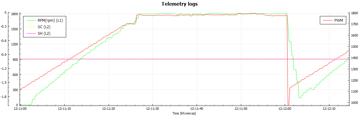

On my HW ESC, I didn't think there was any issue, but last weekend I had something strange happen. Here's the log:
About one minute into the flight I lost power. I didn't know what was going on so I just landed out in the field. I then noticed it was spooling back up and hit throttle cut. I flew the heli four more times, very carefully, and did not have any strange behavior. In the plot I show RPM, SC (throttle cut) and SH (throttle hold). You can see that I did not accidentally hit either of these switches. Also shown is PWM, which clearly shows I lost throttle signal, and which also shows it going back into slow start spoolup as I observed. Not sure if this is related to the telemetry issue I'm seeing with the Castle ESC's (collisions), but I thought I would bring it up because I cannot see any other reason for this to happen.
Posts: 13048
thank you for the message.
Castle and HobbyWing telemetries are working very differently, so potential problems can't be common between each other.
Also telemetry does not affect governor or throttle in any way.
Response from Castle seems to be partially right, except the problem is little bit different. With 100% certainty it is as I have written earlier.
Their telemetry protocol is not designed to work together with Governor since it is using same signal wire for transmitting and receiving data (even if frequency is same).
HobbyWing telemetry is independent from Throttle signal so both can do whatever they want. Since the problems are different, I recommend to open new thread for HobbyWing. Can you add description of what is SC and SH, please?
