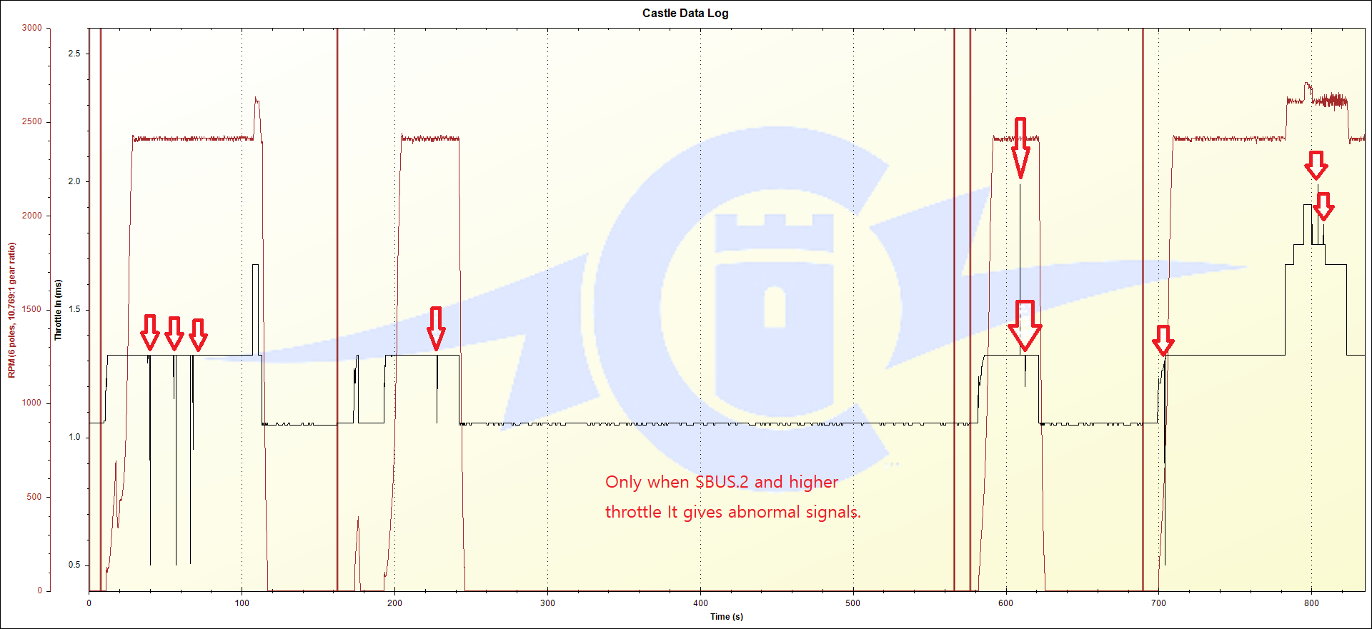

I have nearly same set of telemetry configuration with two helis.
One seems to be okay. But the other one's not.
I found) that Heli gives a throttle tick (sudden spike) while sbus.2 connection.
= I tried to change one by one component with other heli.
= and tried many configurations to find out the culprit.
I Guess)
the only thing left is Spirit HW error or its sbus.2 decoding and sending to ESC algorithm is not stable.
= but the thing is the other heli works just fine with same wiring.
= when I connect it by sbus wire, throttle is stable and heli doesn't jerk sporadically.
Should I send this unit in?

nope, right now I set it as ESC rpm gov.
I tried almost every combination of configurations.
It's nothing to do with gov.
I tested with both gov. off. same results.
____ part of my writing. (I wanted to make sure before telling you)
tested)
7008sb <-(seems problem; when telem off, issues gone)-> spirit pro
spirit pro <-(seems ok; checked by ESC telem off/on)> ESC (throttle)
this is either with ESC governor / spirit governor on/off --- thought this is the culprit not seems not.
