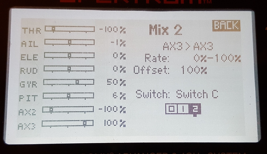

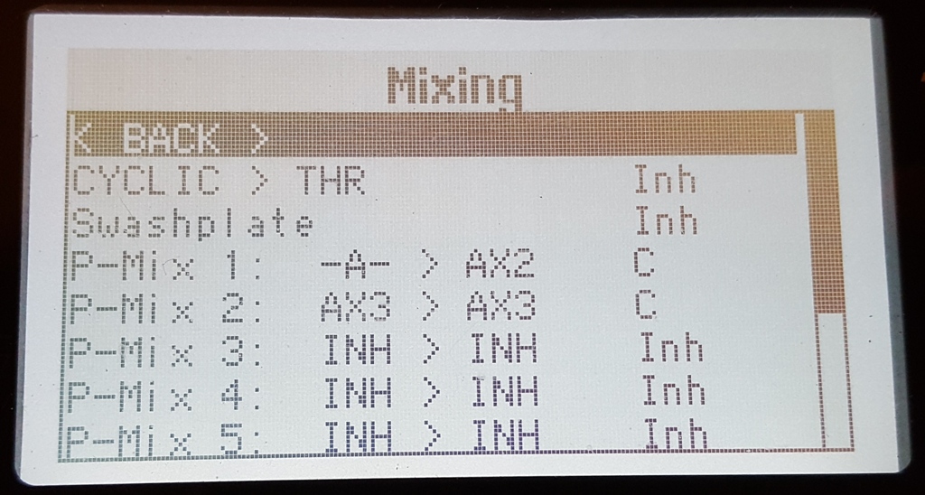

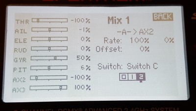

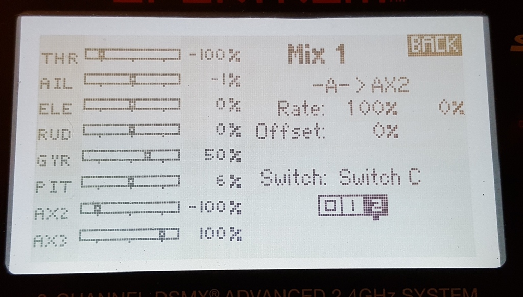

I have my DX8G2 setup the way you are wanting your setup. I'm not sure if the DX8 you have is the original and if it would be the same but mine is as so (copied from my HF post):
My banks are on Switch C and my Stabi Function is on Switch A.
Switch C:
Pos0 - Bank2 (Rescue Acro Stabi Function)
Pos1 - Bank1 (Rescue Normal Stabi Function)
Pos2 - Bank0 (Stabilization Normal Stabi Function)
Switch A:
Pos0 - Function Off
Pos1 - Function On
I wanted Bank0 to have Stabilization Normal turned on when Switch A was on Pos0 as that is my "Rescue" switch. When I flip Switch A to Pos1 for "Rescue" it changes banks to Bank1 and turns the Function On.
Bank1 & Bank2 are unaffected and Switch A just functions as Rescue Function On or Off.
Mix 1 is what throws it from Bank0 to Bank1 and Mix2 is the one that enables the Function in Bank0 without the turning on the Function switch.
