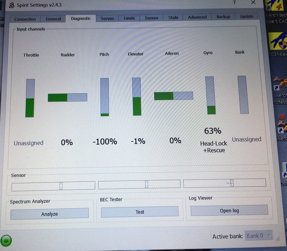

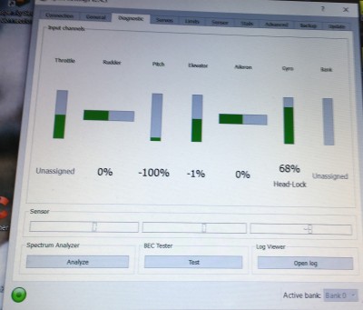

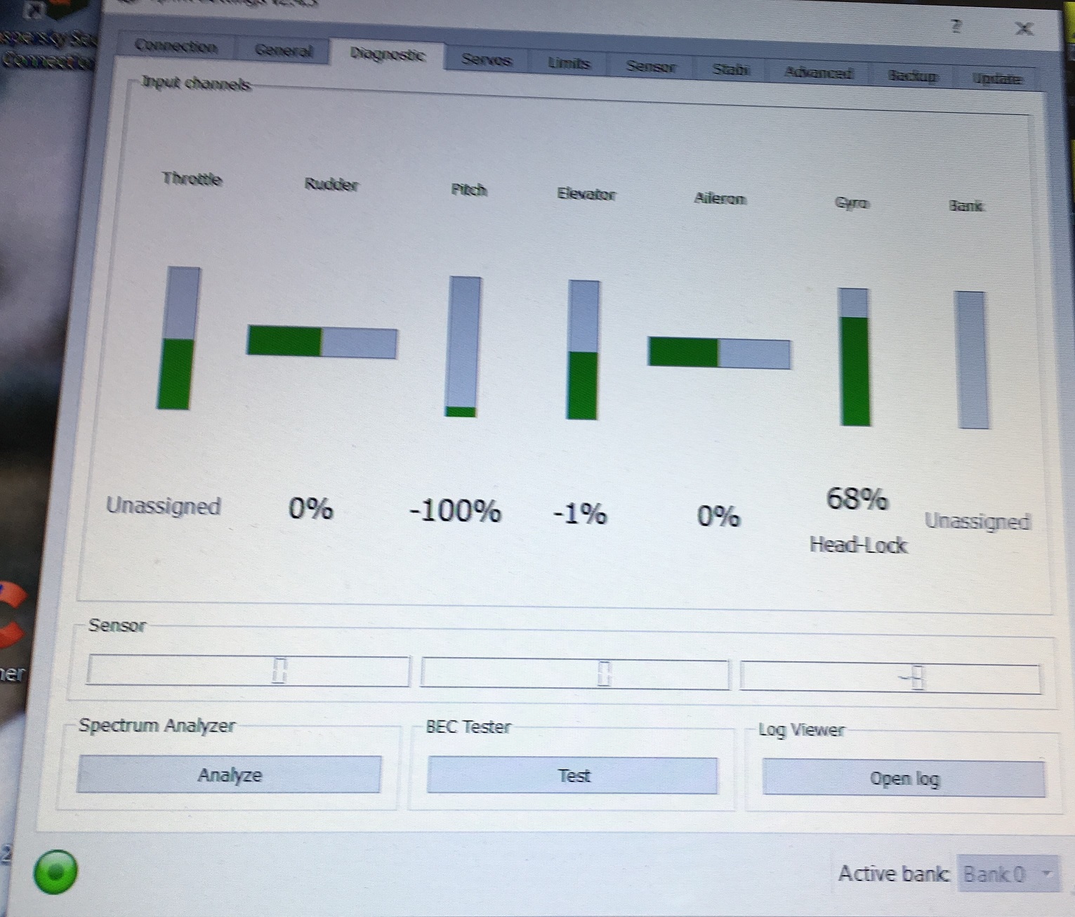

after all settings on my Futaba T8FG like your "set up guide for Futaba" : gain giro at 60%
On diagnostic :
Giro / normal condition 68%
Giro / SH button ON / 63% ("Rescue" appears)
Is it the right setting ? why not 60% for nc and -60% for rescue ?
Thank for you help :)
Posts: 13048
Hello!
It looks to be good. There could be little bit difference between % if channel center is not exact.
For Gyro channel you can fix it by using a Subtrim for Gyro channel in your radio until you will obtain same percentages in both directions.
If you can see + Rescue, then it mean that you have entered negative gyro gain. This is correct behavior. But the actual Gyro Gain for the unit will be 60%. So basically all is correct and even with the gain difference you can fly now.
