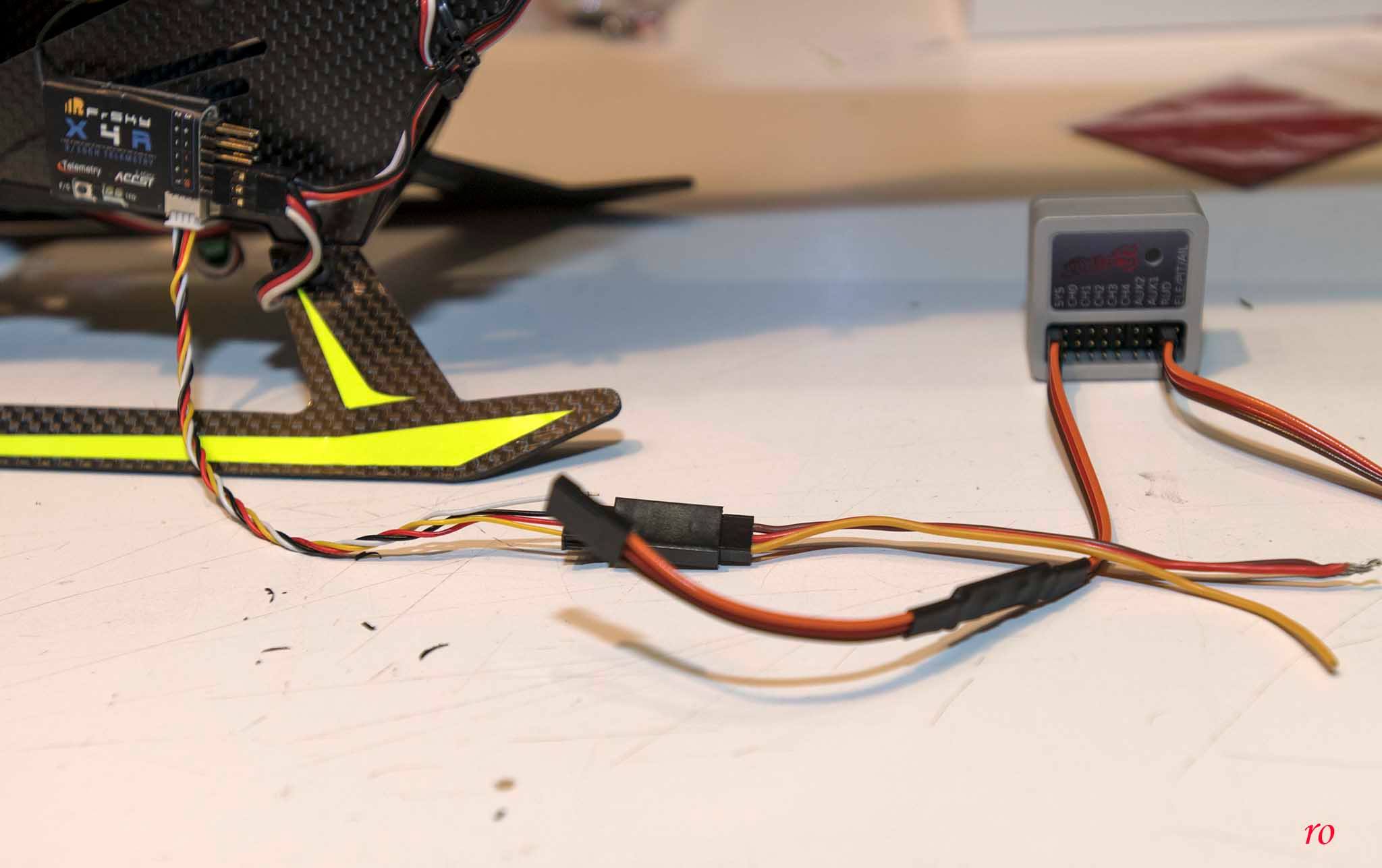

Hello, new here. I have a Spirit Pro and I'm trying to make a female to female adapter cable to connect the supplied X4R smart port cable to FrSky integration cable. First is it the correct cable coming from the X4R and how about the 4th wire (white one)? Can someone point me to the right topic on this board?

You can find detailed photo here:
http://manual.spirit-system.com/images/d/de/O3.png
White wire is unused.
The smart port connector is connected with the FrSky cable. S-Bus port is connected with a normal cable to the RUD port.

ZeXx86 wrote:Hello,
welcome in the forum!
Thanks, ZeXx86 :D
