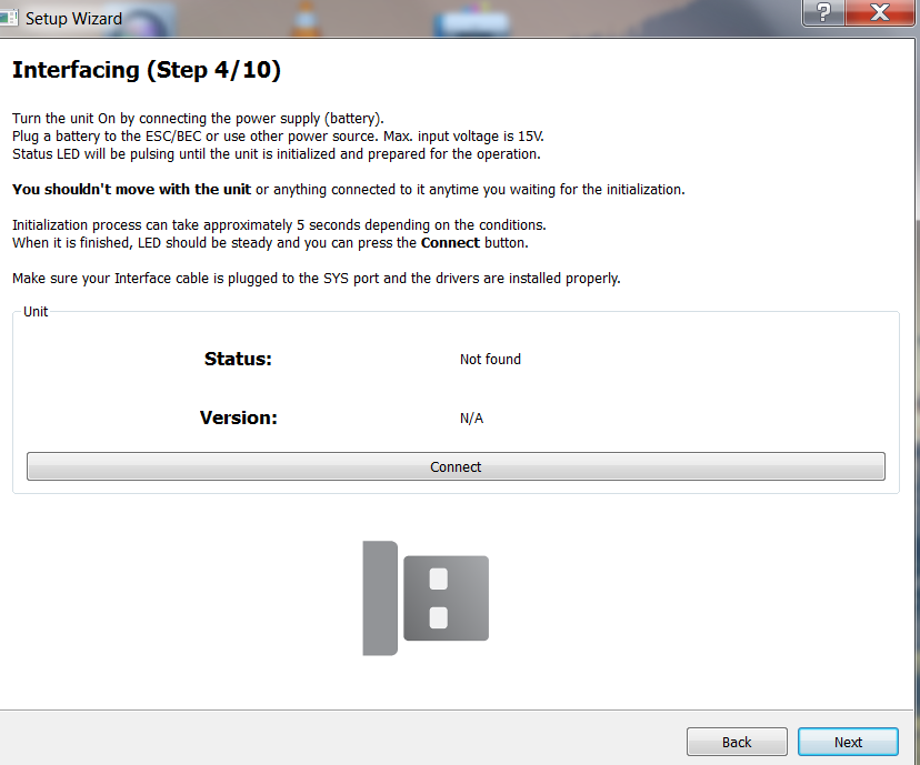

I just tried a X8R receiver. same happens. If I connect ESC to receiver and use these S-Bus adapter, during the setup get a message "device not found" ...

t-guenni
Posts: 9
Joined: Sat 03. Feb 2018 9:51:52
I can't save anything
Posts: 13048
Thank you.
This does not look good.
In the receiver connection is probably not correct.
The SBUS cable must be connected in the SBUS port.
For some reason SBUS adapter cable is connected perpendicular in the receiver.
Maybe it is some different version?
UPDATE: Yes, probably it is a different version.
Were you ever able to connect to the unit through the software? If no, then I think that the problem will be rather in the USB interface driver.
But this is not dependent on the receiver connection at all. So if it worked with PWM, it should work with SBUS too.
If it worked with PWM, then you can do this:
Connect BEC cable to the unit directly (for example at AUX port).
Then start the software and do not enter setup wizard. Then in the General tab, you can simply change receiver type to Futaba SBUS. Save the settings (by CTRL+S or in the Backup tab).
Then reconnect the cables back as it is now and I think it will work.
Probably it does not work now because receiver is sending wrong data to the unit while it is still configured to PWM.

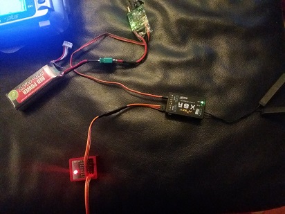

t-guenni
Posts: 9
SBUS is correctly connected, othewice the spirits gets no power. In this picture I tried an X8R receiver, Sbus connector is different to X6R
Posts: 13048
Ah, sorry. Details are unfortunately not visible.
It should be enough to not start the transmitter.
Then you can power up the unit and then set the receiver type.
After changing the receiver you can power up also the transmitter and all should work.
