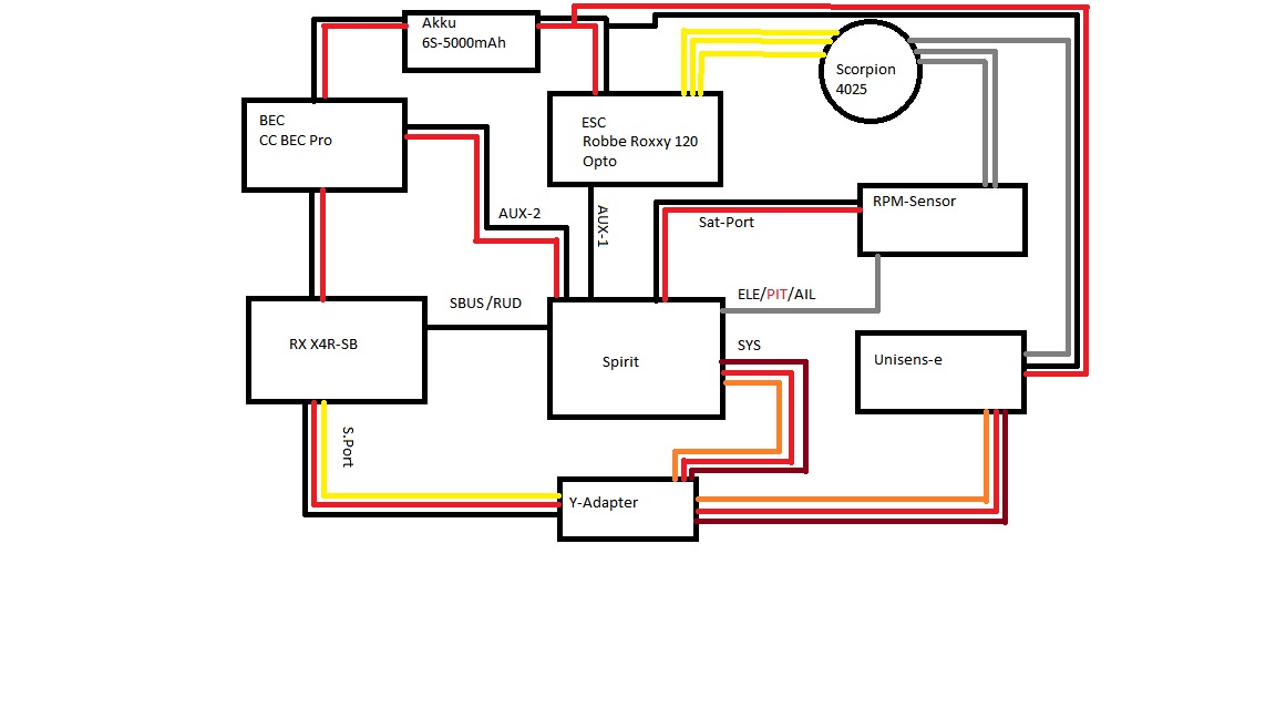

At the SYS input was only the USB interface and just the FRSky cable. A special feature would still be: a Unisens-e I connected via a Y-cable together with the FRSky cable, that should work?

Y-cable will work with Unisens-E and FrSky cable together, but the Y-cable must be connected at the side of receiver, not unit - this is very important.
