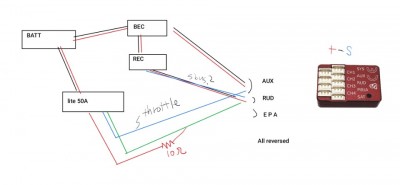

you can power the unit in the very same way as Spirit Pro.
You only have to make sure you are using provided cables and/or our JST adapters.
Wires in the JST connectors are swapped, which is the biggest difference.
Can you describe your wiring please?

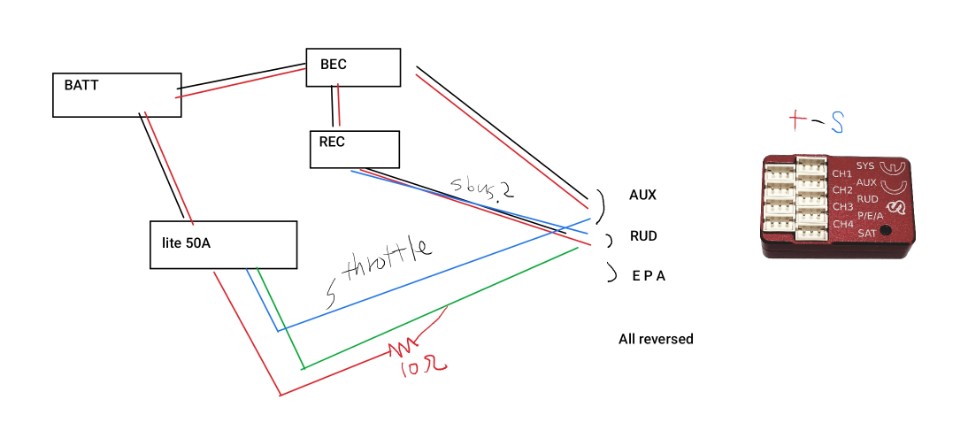

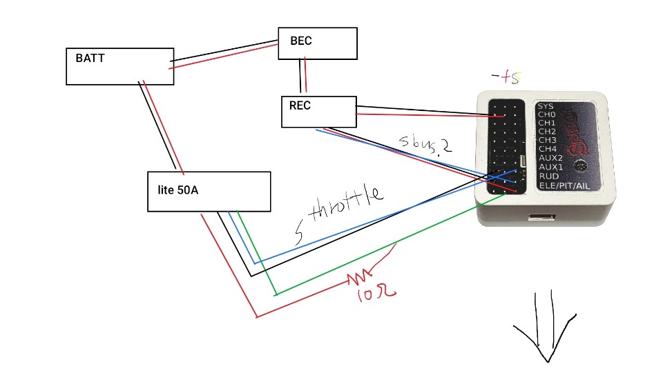

Well basically I used wrong adapter "JST micro to JR" which is (- to -, + to +, signal to signal)
When I am supposed to use included adapter type. which is " - to +, + to -, signal to signal"
Since I was using esc telem and Sub2, Rud and E/P/A +- port is all reversed including servo ports.
Pro was , of course, working fine

If your cables are now connected correctly (just + and - is needed in any powering connector - e.g. AUX or RUD), then it is really bad.
In that case you will have to ship the unit to us. For sure we can repair it (usually in one day) so it will work as a new one.
