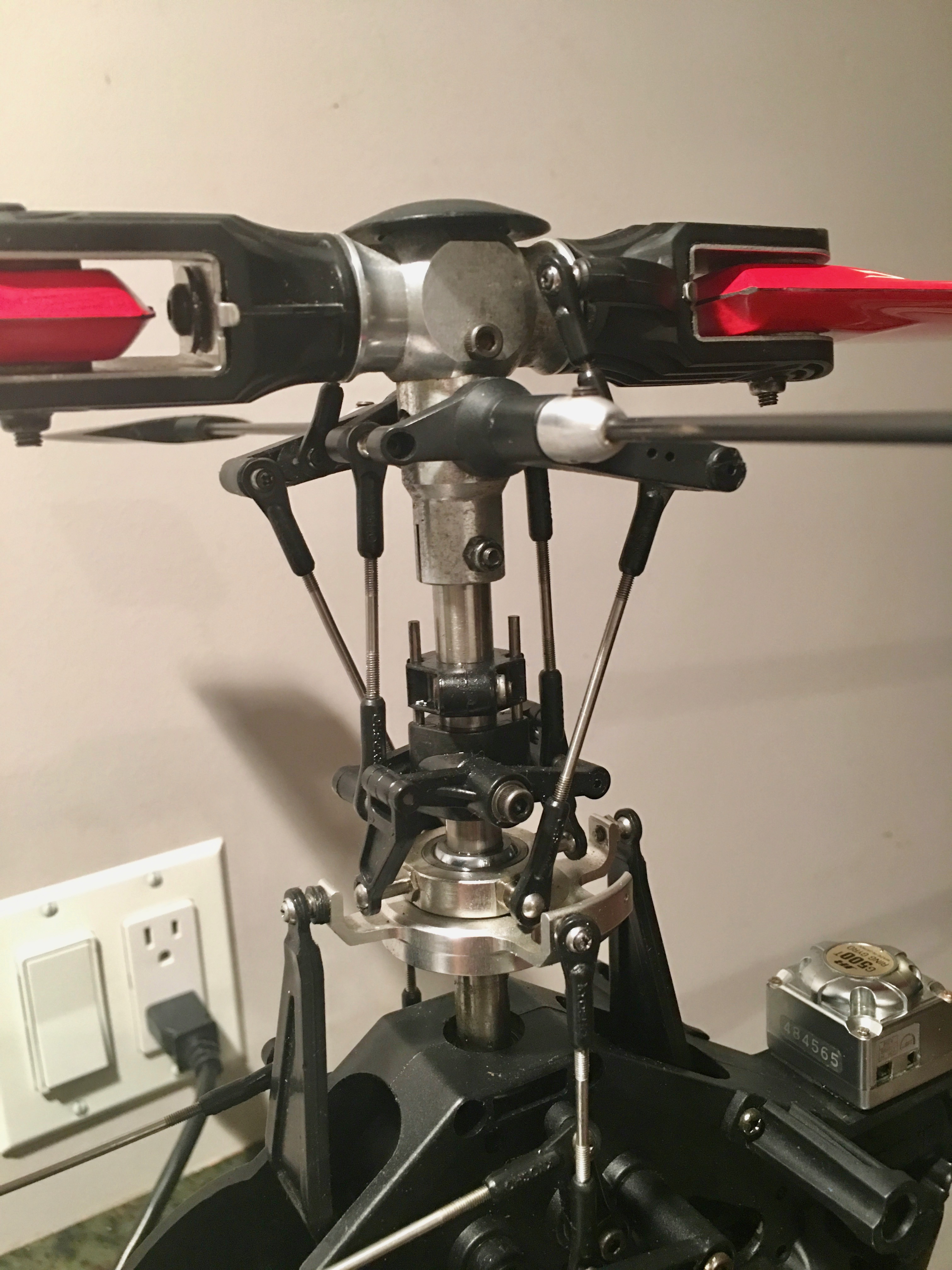

I have a Kyosho Caliber 5 with a flybar that uses mechanical mixing instead of electronic mixing. I wanted to know if the Spirit supports this configuration and if I can use the stabi features of the controller. I have attached a picture of the swash for reference. If supported do I need to take any special steps for setup or just follow the manual?
Posts: 12988
yes, Spirit has support for mechanical mixing.
You have to only set CCPM 90° if each function is controlled separately by a dedicated channel.
It is same for some older Raptor helicopters too.
