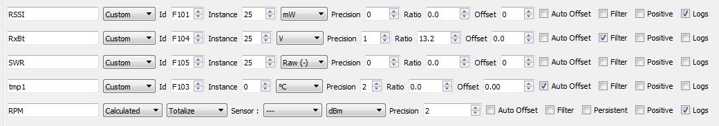

I setup my new openTX model files and based on the Spirit Manual Wiki I set the following telemetry values:
Then I downloaded the sample Horus file and I see these:
Should I add the values in the sample file for more logging, replace what I thought was needed or stick to what I already had?
Also, on Spektrum I get actual Throttle output in my logs via the ESC telemetry options. This is great info as my throttle curve may be 75% but I see the Spirit feeding 100% out using the Spirit governor on hard moved trying to keep the target RPM. Am I going to loose this with OpenTX or is it going to get logged as well?
