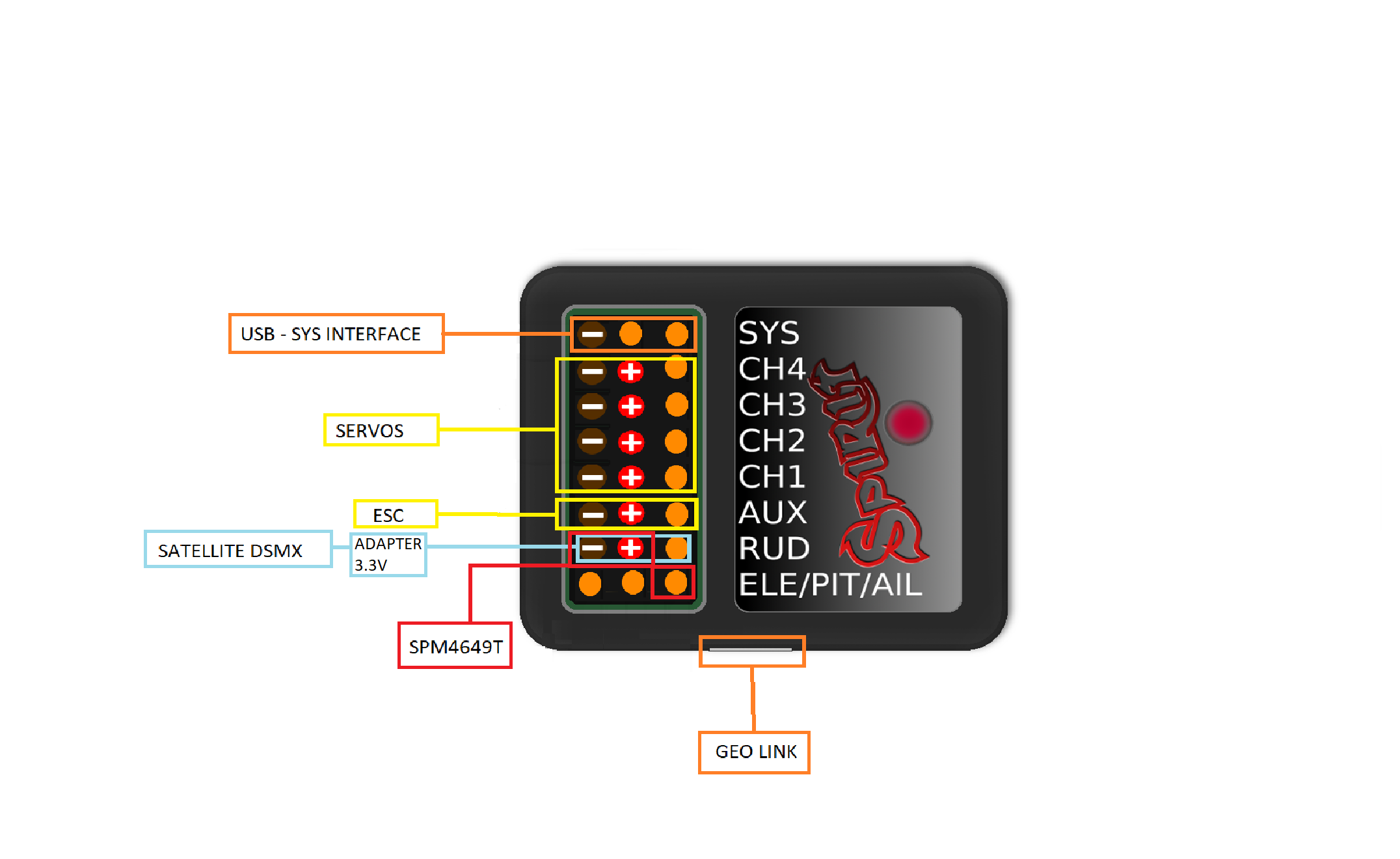

Posted: Wed 08. Aug 2018 9:41:16
by Juan Cobo
From what I understand this would be the correct connection?
Re: Geolink and Standard Spirit
Posted: Wed 08. Aug 2018 10:03:53
by ZeXx86
Yes, that is perfectly correct.

by tdeane
In order to make sure that I have this correctly. I am assuming that I will have the y connector in the rudder port and connect both the Spektrum adapter v2 as well as the 2 pin port of the jeti integration cable to the other end of the y connector.
The 1 pin end of the Spektrum adapter v2 would go into the Eli/Pit/tail port, or I could solder a single cable that matches those specs together.
Is this correct?
Posted: Wed 15. Aug 2018 7:30:57
by ZeXx86
You can solder it together, if I understand you correctly. But there should be 2 separate signal wires (one for RUD port and one for AIL pin). But both satellites (Spektrum adapters) will be powered from the same port (RUD port).
Posted: Wed 15. Aug 2018 12:36:37
by tdeane
Got it. So in practice this could work for two satellites or for one satellite and a SPM4649T receiver. Thanks again.
