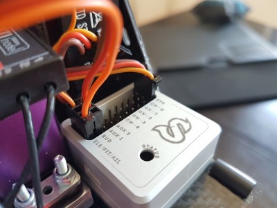

Could you take a photo of how the telemetry cable was connected in the unit?

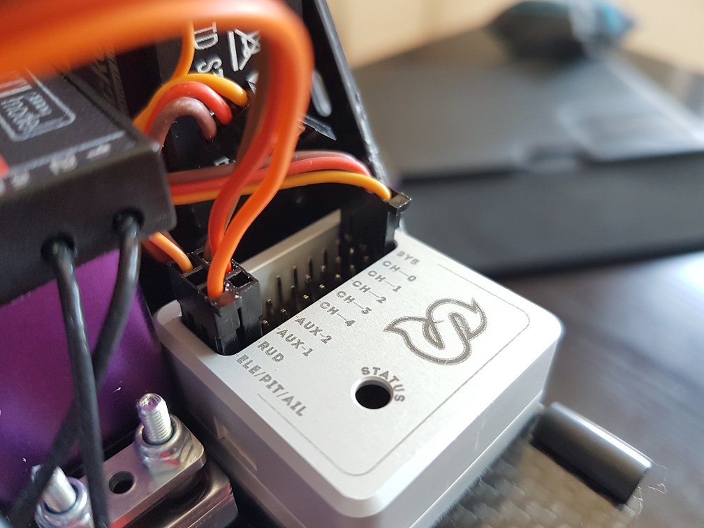

I have removed everything but BEC-Slave from the Spirit Pro und the LED still pulses für 16 seconds till it stays solid red. :(
Then I tried to connect it to my windows-pc in this configuration but the device isn't found though the transmitter is turned off and the connection to the RX was pulled. Also the recovery mode doesn't work in this configuration.
Here's the Picture:
So I describe what is connected:
Kontronik Telemetry
- Single cable: ELE-Pin
- cable with three pins: SYS-port
RX
- orange cable: AIL-Pin
- red and brown cable: RUD-port
So, what can I try next? :cry:
With kind regards,
Thomas
Posts: 12997
From the photo connection looks good.
Unfortunately it look like the unit is somehow damaged. But without wrong connection this should not happen in any case.
Do you have any multimeter? If yes, you can at least measure if some high current/voltage went in a wrong pin.
I can tell you how to measure it.
Unfortunately it will be needed to send the unit to us.
