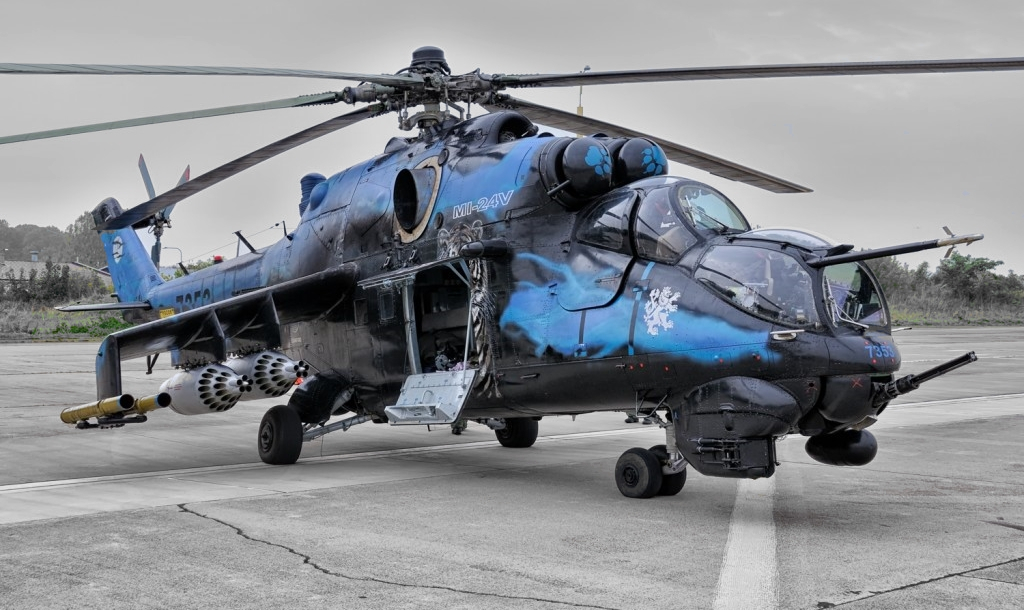

I also posted this over on Helifreak, but I thought better to come to where the experts actually live...
Well, I had a crash on the mechanics that are going in my Mi24 scale fuselage. Trying to figure out what went wrong, and hoping for everyone's thoughts.

Fun to look at, not so fun to get into the electronics.

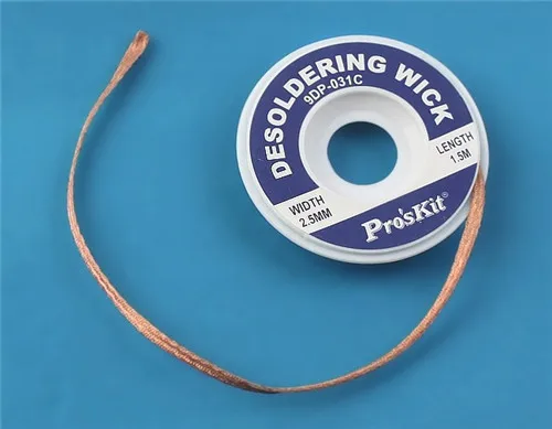

maybe you can fix somewhere near the belt a small piece of copper mesh
connected to the ground of helicopter so the mesh will pick the static and discharge it
before to much charge will build up and generate a spark

The model looks really awesome so it would be really sad to see it damaged.
