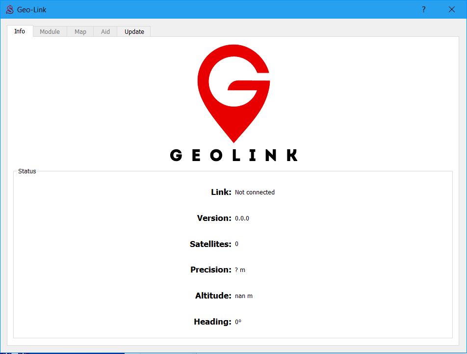

After updating geo-link to fw-1.0.2 the software spirit 2.5.2.shows me after rebooting,that the geo-link is not connected,and blue LED blinks for a while,but than it turns off.
I tried to flash in recovery mode,but after doing this I get the message : update failed.
So what can I do ???
Greetings,Robert

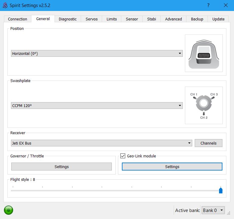

either the Spirit unit is not updated to 2.5.2 or the GeoLink is in calibration mode.
Is it flashing or it is steady on for a while - after power up?

I've updatet my Spirit to 2.5.2 and when I power up the blue LED on Geo-Link is flashing quiet different,and than it turns off.
But when I move the Geo-Link the LED flashes a short time,and than it turns off again.
The Spirit-Settings show me,that Geo-Link is not connected.
Posts: 12928
In that case your GeoLink is in the calibration mode and it is normal behavior.
This behavior is always occurring when you click at the Compass Calibration button in the Spirit Settings.

I've been waiting for over 10 minutes,but the LED ist still off and the spirit setting shows me still,that geo-link is not connected.
Posts: 12928
Unfortunately waiting will not finish the calibration.
Calibration must be finished according the manual.
Please see this page:
http://manual.spirit-system.com/index.p ... on_process
Posts: 12928
This video from one pilot can help you with the process:

thanks for the links....now I got connection to Geo-Link...I think,I was a little impatient with calibration...
thx a lot....now it's working ;-)
