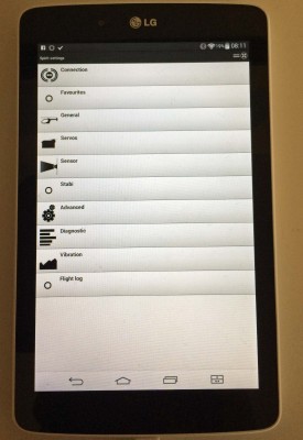

Here is a screenshot, the button below are "back", "home", "last apps", and "dual screen" the lg hasn`t that menue button. I dont know how many other devices are like that.
My problem is, the lg is my only Android device all others are IOS. ;)

LG uses some custom panel and it looks like it ignores the command view "option menu"
Check it out here if it helps http://www.androidpolice.com/2013/11/05 ... -software/ "Homescreen, Launcher, and Navigation"
For greater comfort he probably I'll add that button to the application
apologize for the trouble
