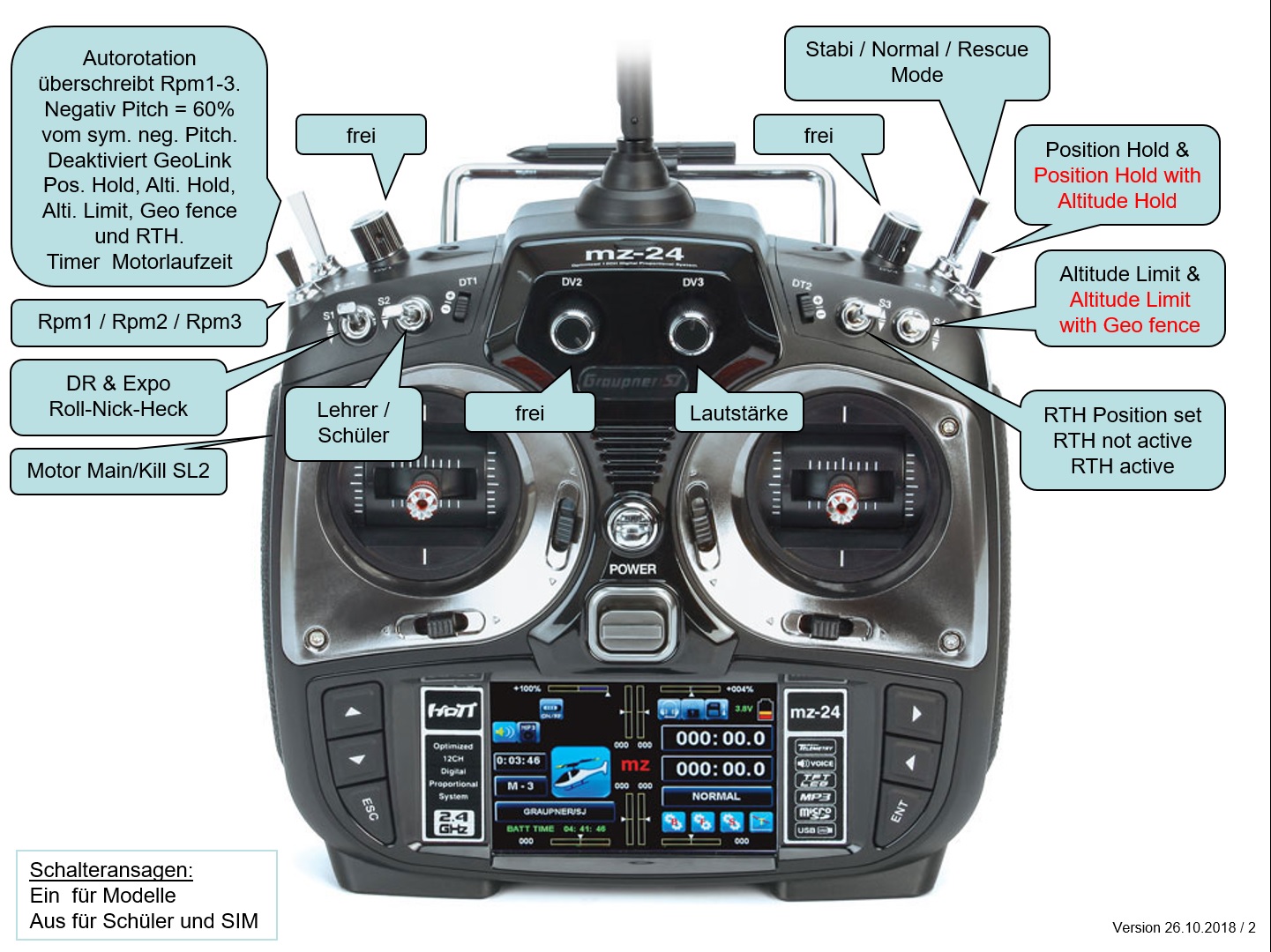

enied
Posts: 107
This is how I set up my transmitter. Functions in RED will be available when more than 3 channels can be configured. I use 12 channels in total here.
BR Eugen
Posts: 13054
Thank you for the photo!
