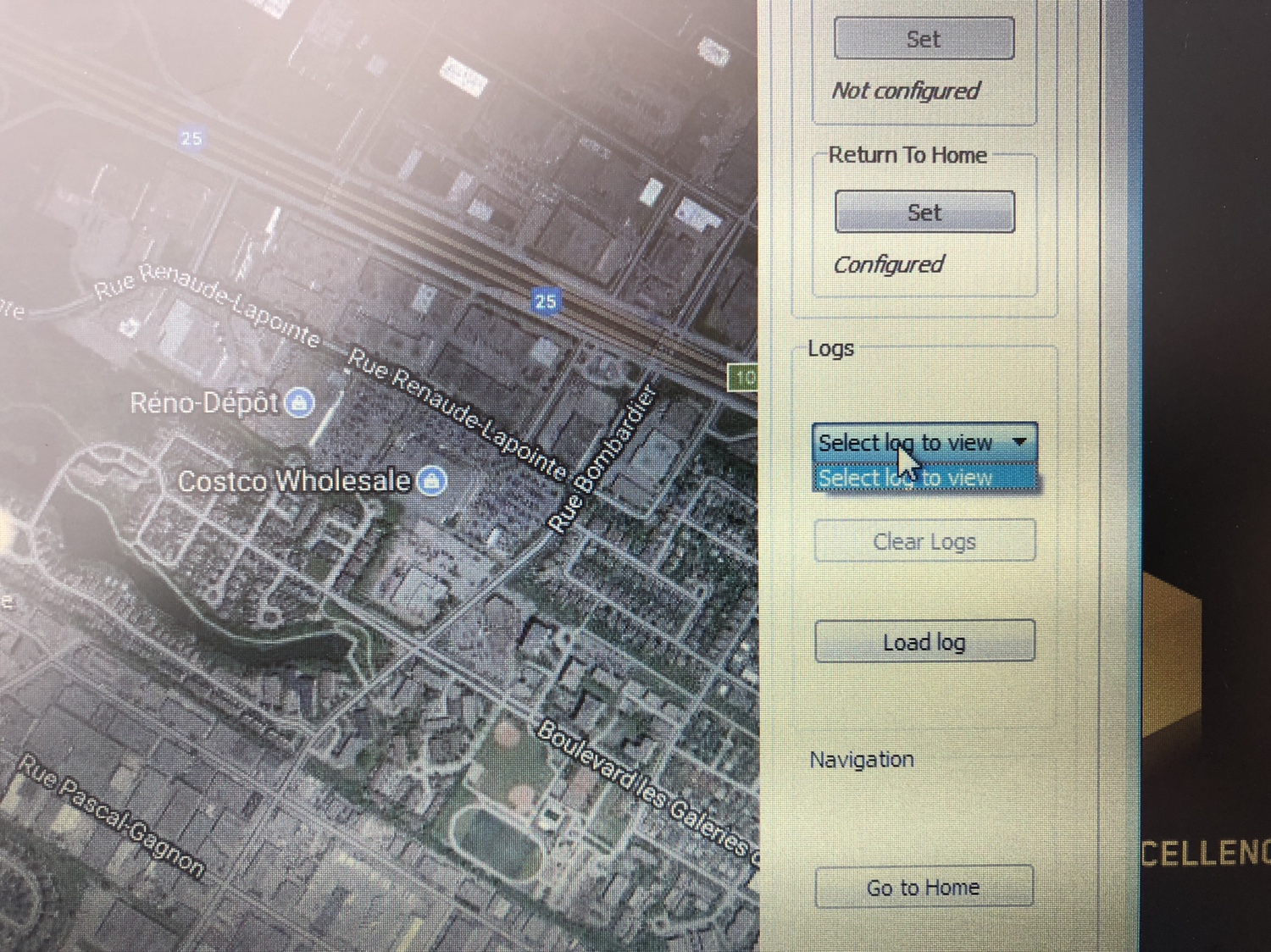

Weirdly, the Geolink is showing the right location. When I got back to my house, I looked at the map and my home location was around exactly where I set it. The current location shown on the map when I was at my house was exactly where the helicopter was. The Geolink was showing very accurate data on the maps. Also, there were 12 satellites and the Geolink even showed 12 satellites indoors. It seems like something is seriously wrong. I am on the latest version for both Spirit and Geolink. Please tell me if any of you have these problems.

Thanks for the prompt reply!
I used the cable that came with the Geolink from the Geolink box. I don't have any other cable and I have not modified the cable in any way. I just received the Geolink last week and had this problem from the beginning. There are no magnetic canopy mounts either. The geolink is mounted at least 6 cm from the tail servo and way farther from everything else. I think I will put up a picture of how my Geolink is mounted. Maybe that will help you. Still, I don't know why it would act like this. I will try to get in another flight maybe today if I can. Hopefully, I can get more data.
The funny thing is Geolink shows the exact and correct location on the map and it shows the exact home location. I don't know why it would be directing the helicopter the wrong way if it knows the right location and even shows it correctly on the map.
Anyway, I will try another flight if I can today and see if I can get more useful information from the logs. Thanks!

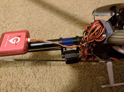

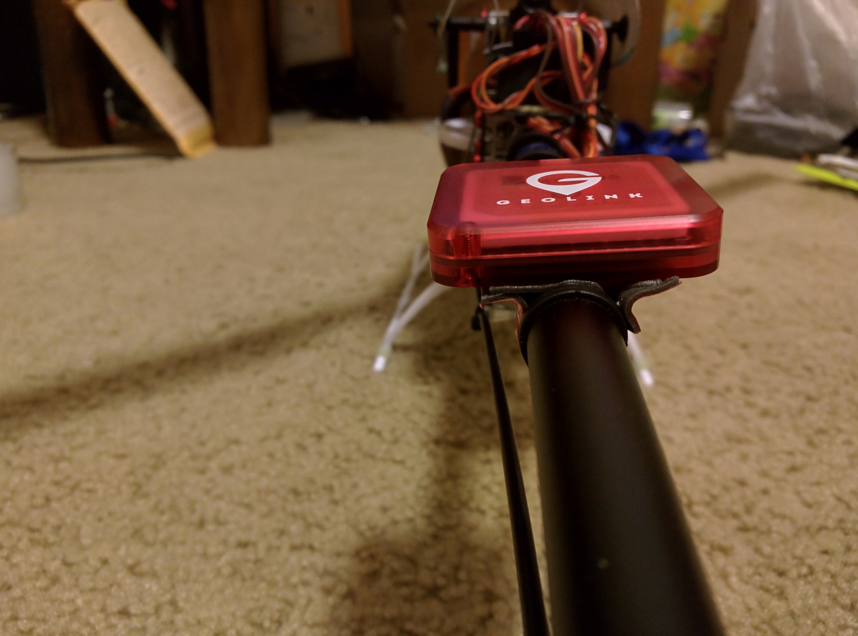

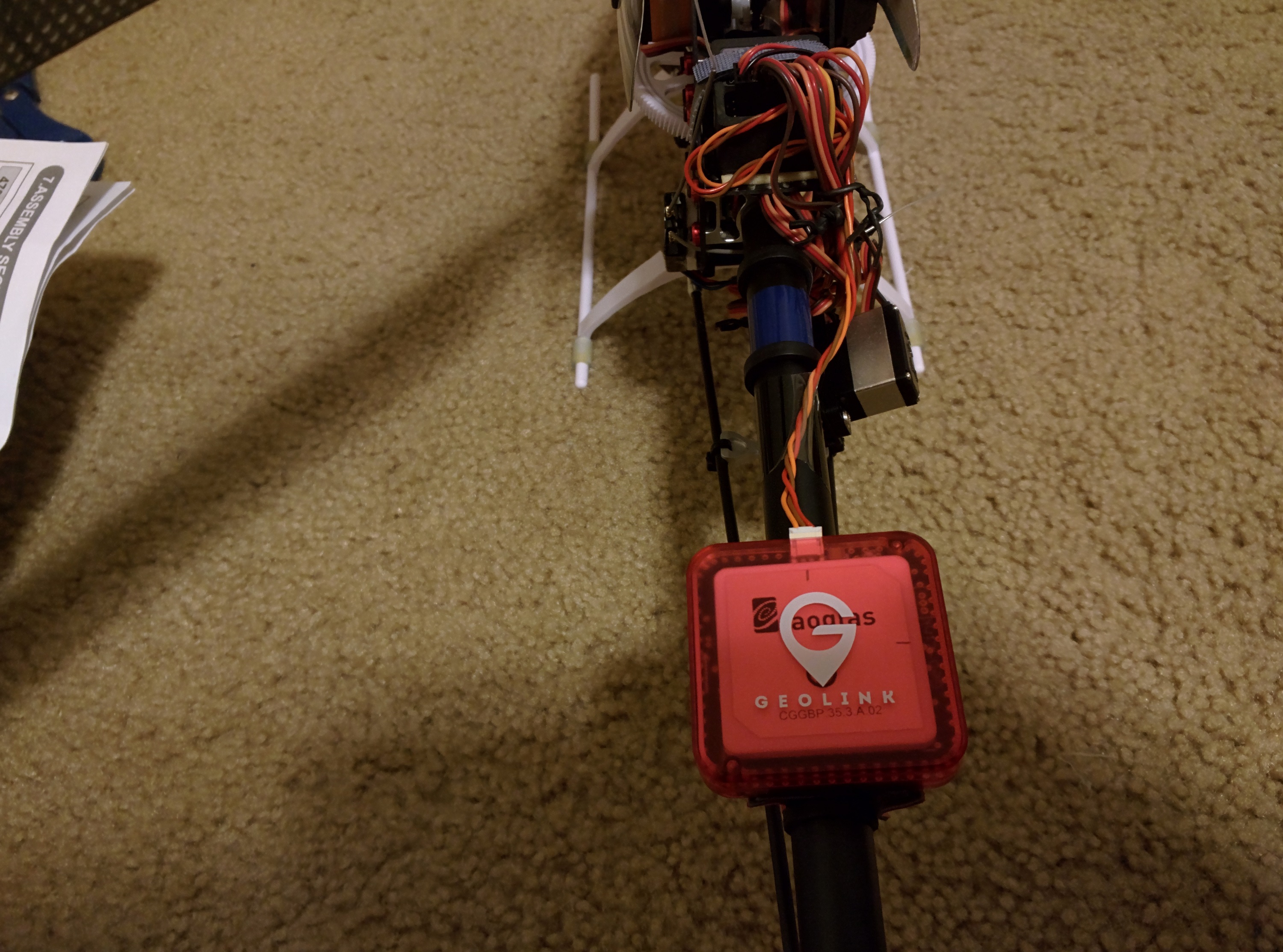

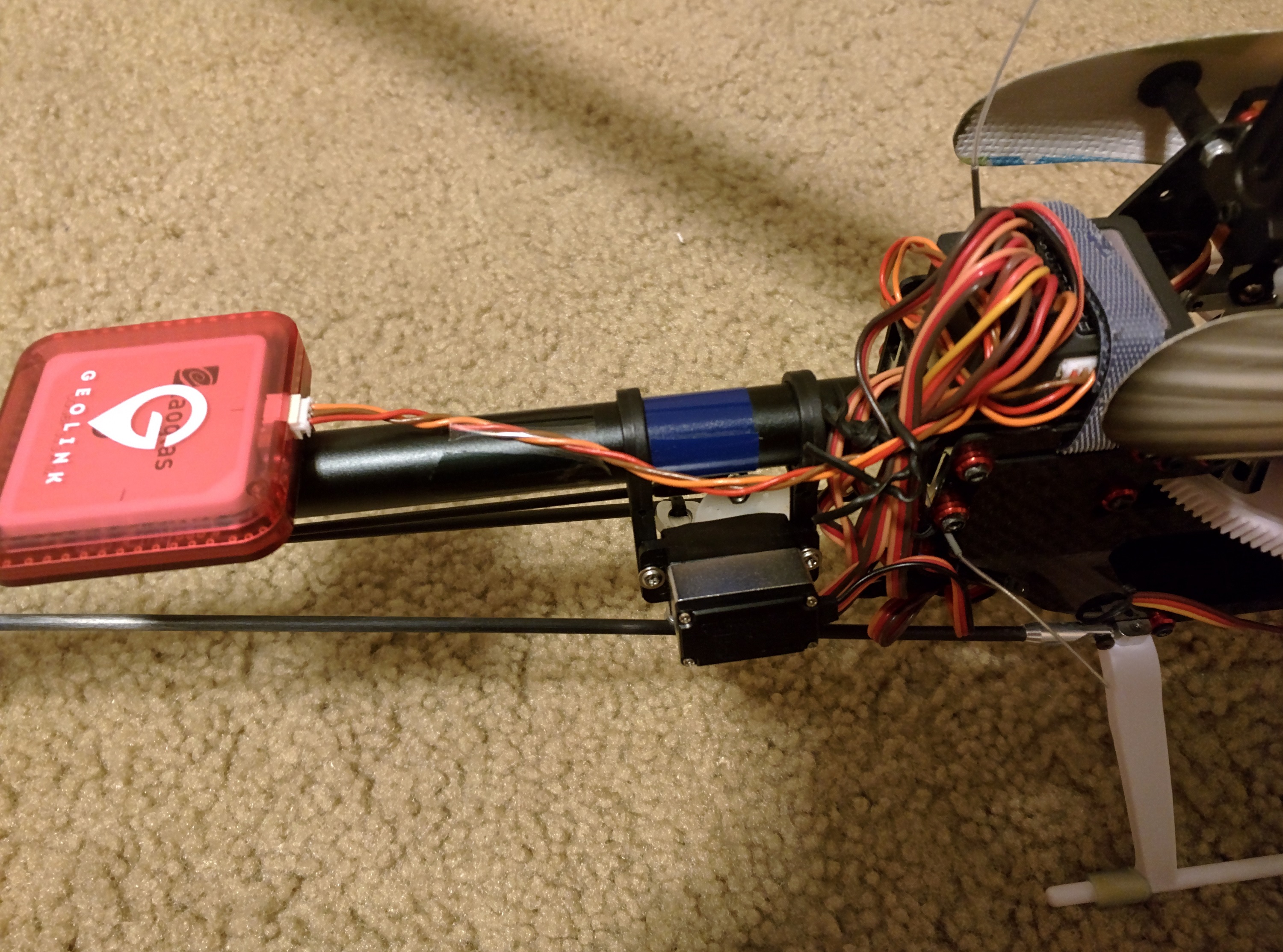

Thank you. Your mounting is looking good.
Could you also provide other details about the model (ESC, BEC voltage) + 4ds settings file.

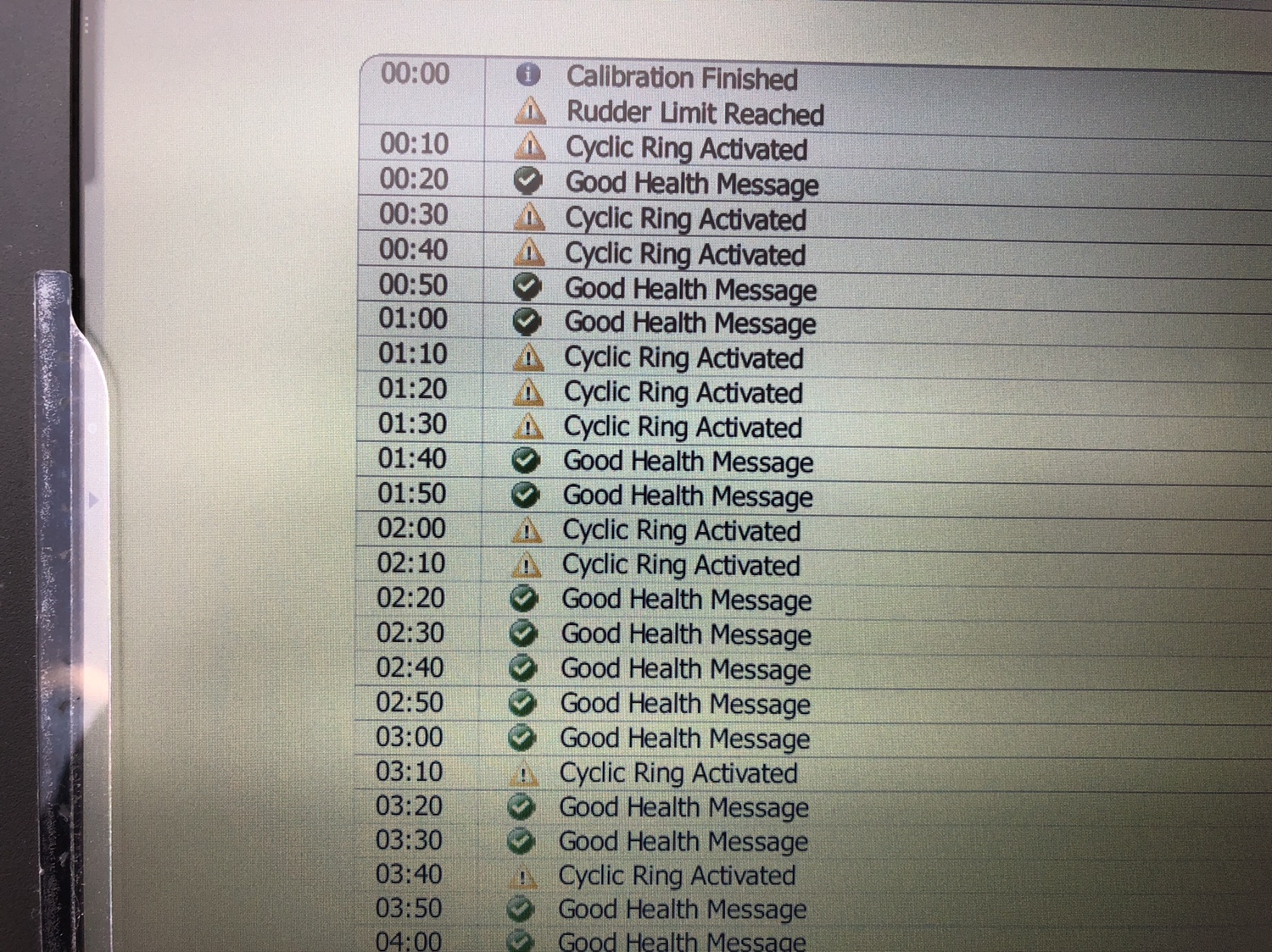

I got to fly today. I did another calibration of the Geolink in the field where there was only grass and no metal objects. The calibration went successfully like normal. I then unplugged the battery, then plugged it back in and flew the helicopter. The helicopter flew fine, but when I activated position hold, the helicopter just went in whatever random direction it wanted. It didn't hold position at all. Altitude limit was also kind of unpredictable sometimes activating too high and sometimes activating almost too low. The new firmware didn't fix any of the problems. The good thing is I got two logs you can look at which might help you in solving the problem. Please see the attached logs. I saw there were a lot of Geolink data corrupted entries. The logs seem to show something is seriously wrong. Please help me. Thanks!

Thank you for the logs.
Could you also share your settings file, please? Is the BEC configured to 5 - 6V? Or is it higher?
From the flight log it is really looking bad from 13th minute. Do you remember if the model was still in the air?
It is quite long run.
First we have to check the basic settings.
1. When moving with the sticks all bars should correspond with direction you are moving in the Diagnostic tab. This mean when you move with collective pitch up the bar goes up (100%, not -100%). When moving elevator stick to front the bar should go up. Is it correct? So it is important that Aileron, Elevator, Pitch and Rudder channels are moving well.
2. Is GeoLink mounting option configured correctly? In your case it should be Horizontal (0°), right?
If no, then all corrections will be opposite so it will look like a random.
When GeoLink data are corrupted event occur it should be there maximally 1 time per minute, but if there are multiple messages in row then it mean that it really can't work correctly.
Did you checked if Compass is showing correct angle - in comparison to at least any other compass?
Because if it will show wrong heading then it is not worth to do more tests.
If you know where is north then it should display around 90° at the GeoLink window.
