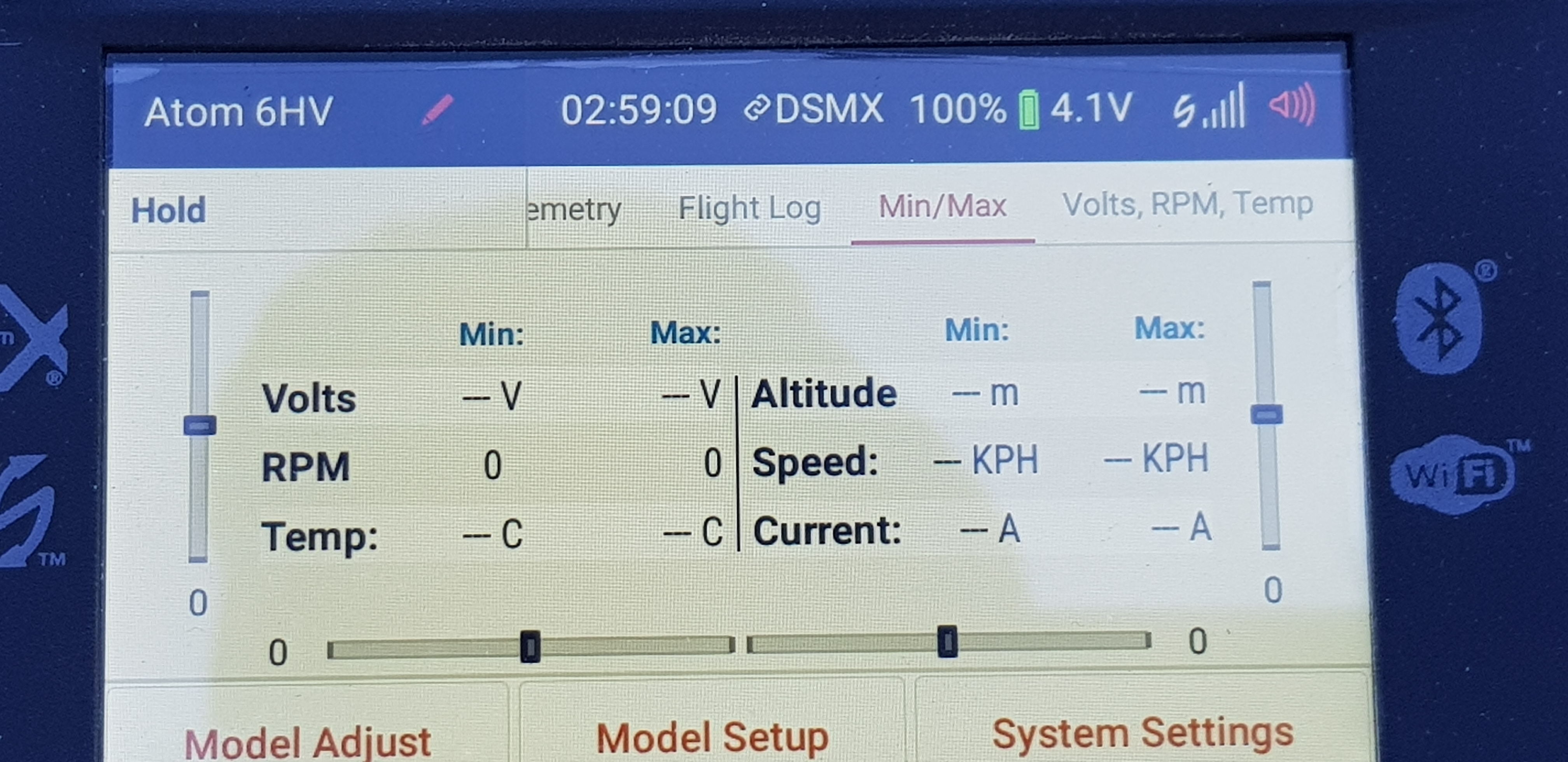

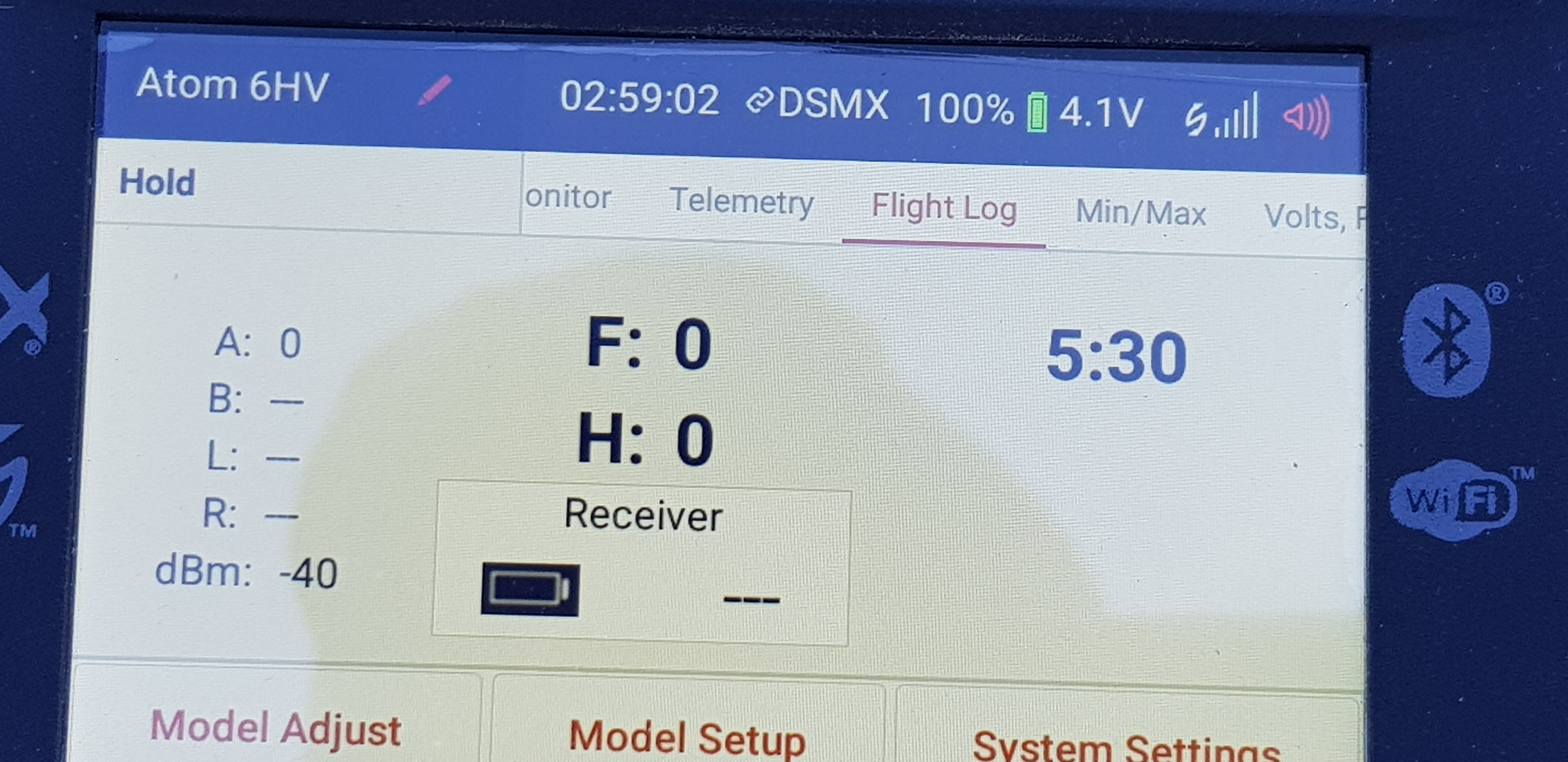

Got an ix12 to try from a buddy. My Telemetry worked on my DX9 with 4649t and H.W. 120a V4. Made no changes to the heli all I did was the bind process to the ix12. Performed the Telemetry Auto Config. but do NOT get a telemetry page for the ESC. Spektrum was no help. Any ideas ?

I too got some issues with telemetry and ix12 , I don't get readings on the screan and some very crazy readings ESC page : motor current was showing @27000A while flying and thats way off , worked fine with DX9
my setup :
- Spirit Pro
- SPM4649T with one sat
- Scorpion 130A Tribunus
- ix12 TX
all are updated with the newest firmware

tried the new firmware but not changes , still no readings on telemetry
