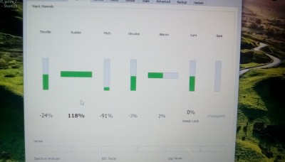

I can't do any set up due to the rudder reading in the gyro all i have done is bound it to my DX9 , then when I try to do a set up in diagnostic the rudder is at +118% even tho gyro gain etc is zero in the transmitter i have even reversed the servo this did nothing also tried to adjust servo travel and it still reads +118%

I hope you can see screen shot of what I am getting

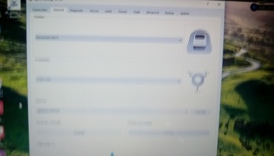

Please share your 4DS file - you can get it from the Backup tab.
The second photo is unfortunately completely blur. But if you will attach the settings file then you do not have to take any photos.

Hi it's a Trex 500 pro it flys 100% it has the standard align servos a castle bec the spirit gyro is used as the receiver , DX9 transmitter, the only way I can set up is to assign the rudder off channel 4 to channel 7 but now I can't use bank switches for acro stability and rescue the transmitter works 100% ok on my other helis just tested it ,the gyro is showing 118% on rudder any time you assign it to rudder all other channels work rudder 100% right
