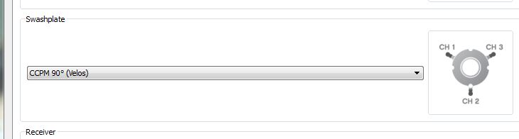

Hello, I have to mount a Spirit on an antique thermal Raptor 50 with bell bar, I do not know what I have to put in the Mennu Spirit (general/ swashplate), the cyclic is on 2 servos and not on another? Thank you for your advice.
Cdlt
Posts: 12988
please select Swashplate type to: CCPM 90.
If you mean that the model is equipped with a flybar, then after finishing the Setup Wizard, please do not forget to tick Stabi/Flybar mechanics.
Then it will work well with Raptor 50.

Hello, yes it is with help bar, but the translator does as he wants: o))
I saw 90° it's OK but what do you mean "vélos"? and I have a problem with the display (right)

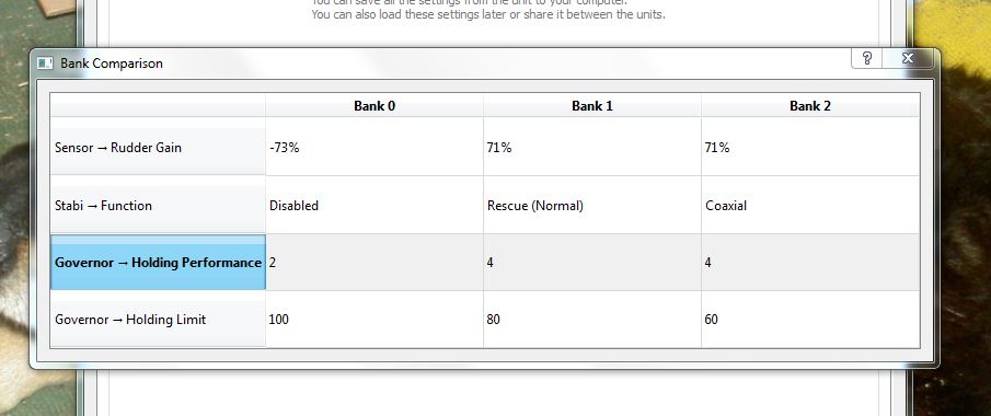

Proposition:
would it be possible to be able to change the values from the "bank comparison"

Velos is helicopter model that require such mixing.
In the future it can be possible to change parameters from bank comparison.
