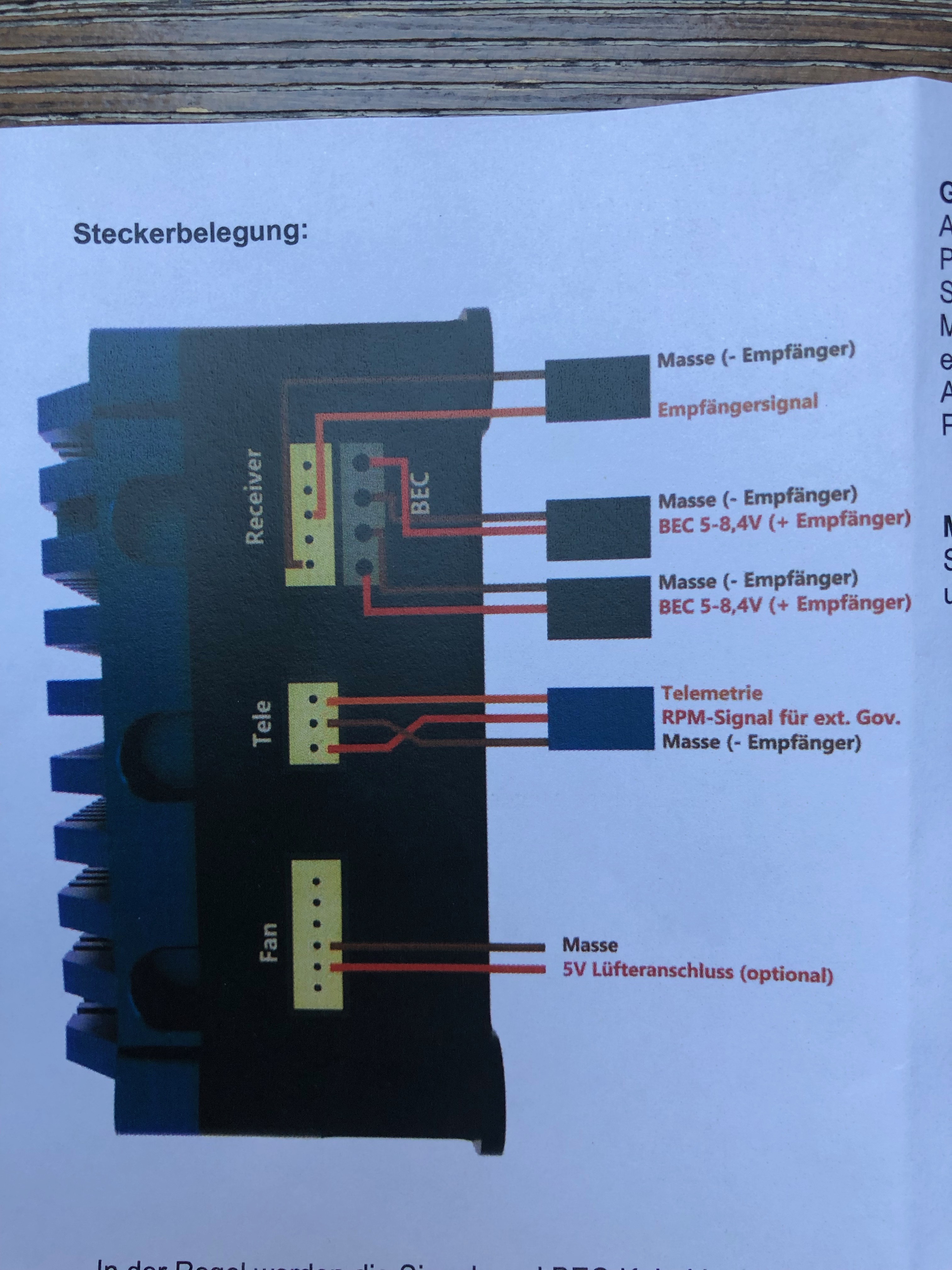

Hello!
How do I connect the new YGE 205 HVT with BEC to the SpiritPro?
The YGE protocol is also intended for the Spirtit FBL-System!
Jeti EX Bus is possible.
My equipment:
REX3, SpiritPro and YGE 205HVT with BEC
Photo attached.
Thank you!
Greeting Frank
Franky13
Posts: 135
Joined: Tue 30. Dec 2014 7:50:36
Nobody a suggestion. Or maybe tomas?
Posts: 12928
If possible, combine BEC cable and Throttle signal into one cable - primary.
Second cable will be just for BEC - secondary.
This will allow having just two cables instead of 3.
Then connect primary cable at the AUX1 and secondary at the AUX2 port and all will be fine.
Telemetry can be connected in a way you wish - to JETI receiver or Spirit unit.
Franky13
Posts: 135
Ok, thanks!
I then put the receiver signal cable in the BEC cable.
The minus cable (from the receiver) too, or "disconnect"?
Then the new BEC cable in AUX1!
Greeting
Posts: 12928
It should be enough to use GND (-) from BEC connector. So Receiver GND will be unused.
