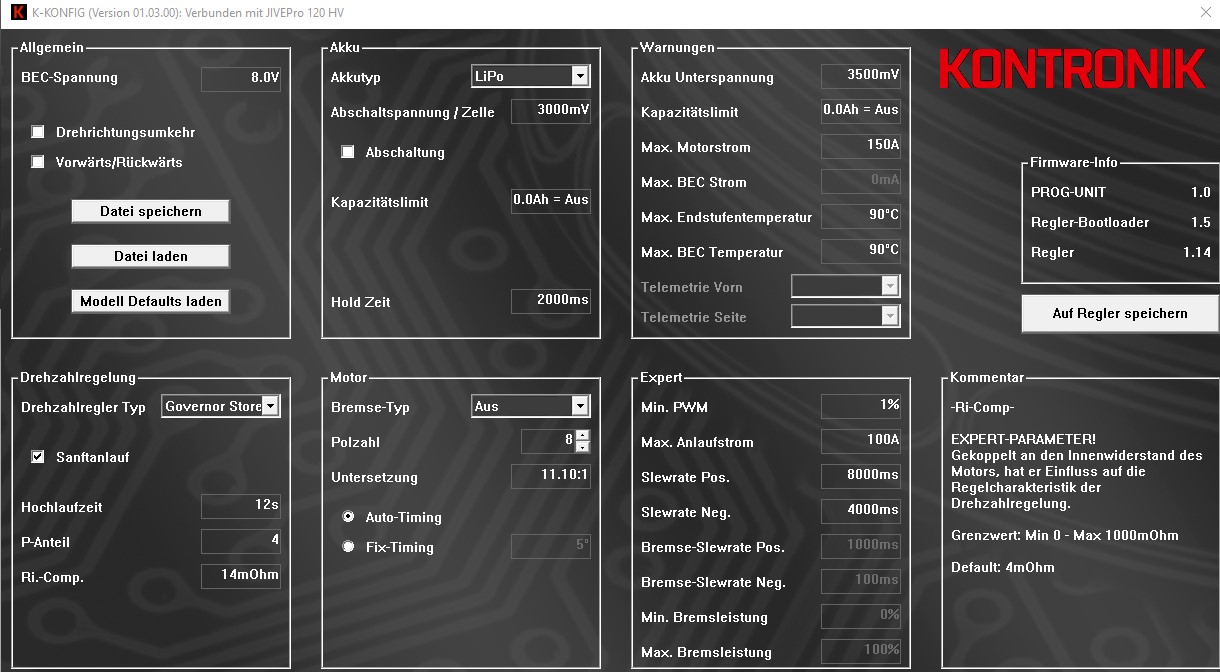

There is still no telemetry reading. For your convenience, I have added the Kontronik config in case you want to have a look at it (it is in German, so let me know whether you need help translating it).

Current Kontronik Jive Pro 120 HV Settings (I have a motor with 13,5 Ohms internal resistance)
