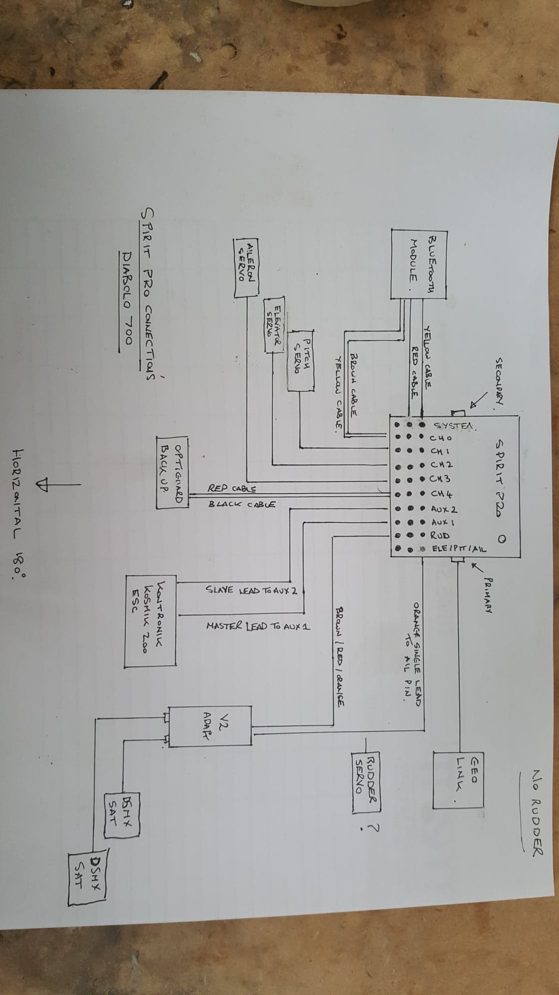

need a little help with my set up on my new heli , i allready own and use a spirit pro in my goblin 700.
but i havnt connected as many components to the spirit pro before . so to make it easier for me to see a drew this layout according to each individual components wiring connection on the spirit web site .
however with this set up as drawing i have nowhere to connect the rudder ?
appreciate anybodys input to set me in correct direction

rudder servo should be connected at the CH4 port. I recommend to connect Y-cable that we are selling at the CH0 port. And there to connect BT powering lead and OptiGuard backup.
