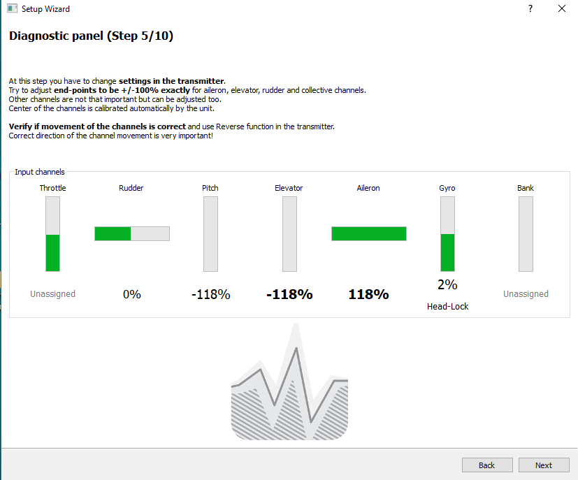

ok so here is what I have on my screen , when i move Tx stick only rudder response
connection
Spirit Pro
ELEV/PIT/AIL - Rx 2/Rx 3/Rx 1
RUD - Rx 4
AUX1 - BEC
CH4 - rudder servo
CH3 - pitch servo
CH2 - elev servo
CH1 - aileron servo
no other connections , no response from pitch/elev/ailer servos
what's wrong ?

Posts: 13054
Can you tell me what receiver it really is, please?
Unfortunately I can't find any receiver such as 2000SB from Futaba.
If it has 4 ports then it is designed usually for S-BUS. In that case I highly recommend to use S-BUS.
Otherwise you will be unable to connect throttle anywhere.

Posts: 13054
Thank you. Then please connect the cables as I have written in the original reply.
For some reason you have wired it differently in the receiver.
Anyway usage of the S-Bus protocol would be much easier, more reliable, faster and precise.
