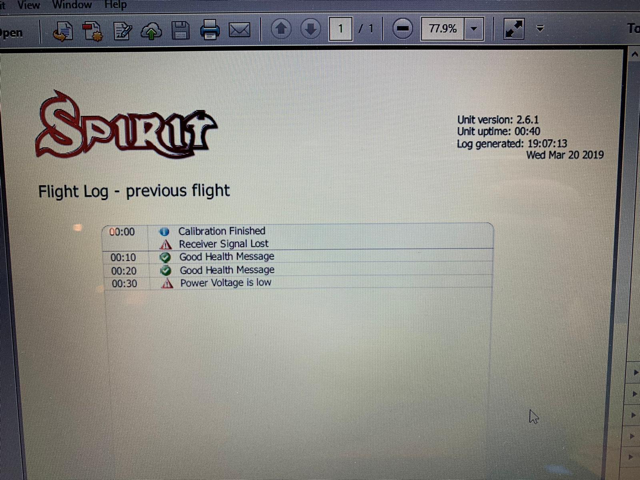

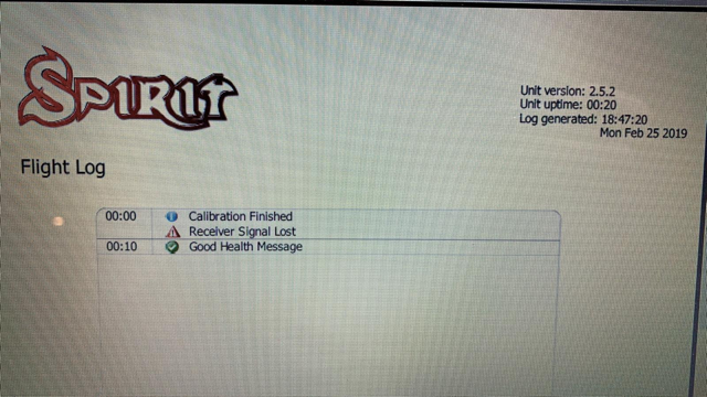

Spirit log attached. I'm reading this that the Spirit re-started and calibrated mid-flight (for reasons unknown) but after it re-started it did not pick up receiver input? The log from the last spoolup incident is identical (attachment #2). The low voltage at the end of the first log is i think just caused when the battery went flat.
So why does the Spirit re-start? And why doesnt it either pick up the receiver signal, or go into failsafe? Could this be a static hit?
Today's flight and crash
Spool-up incident from 3 weeks ago
Any suggestions greatly appreciated cos my buddy is pretty frustrated right now and the intermittent nature of the fault makes it very hard to nail down. As i mentioned earlier, I'm now suspecting static mainly because i cant think of anything else.
