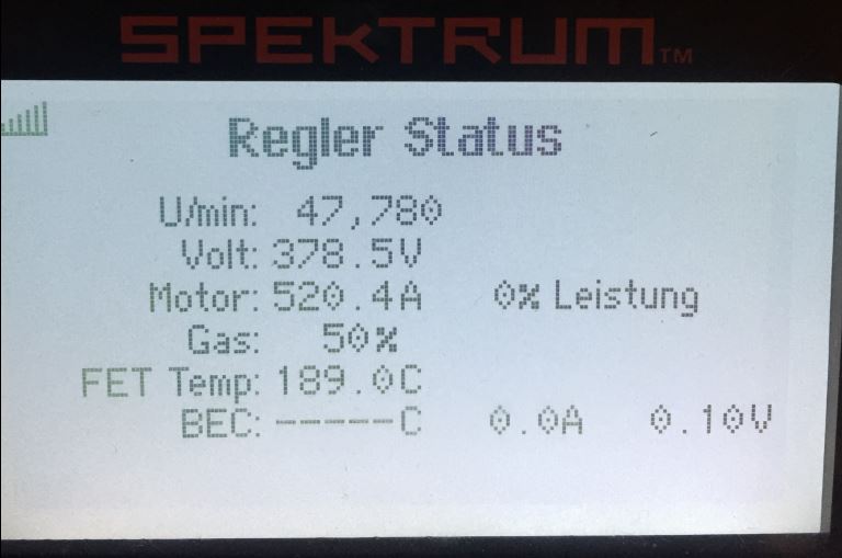

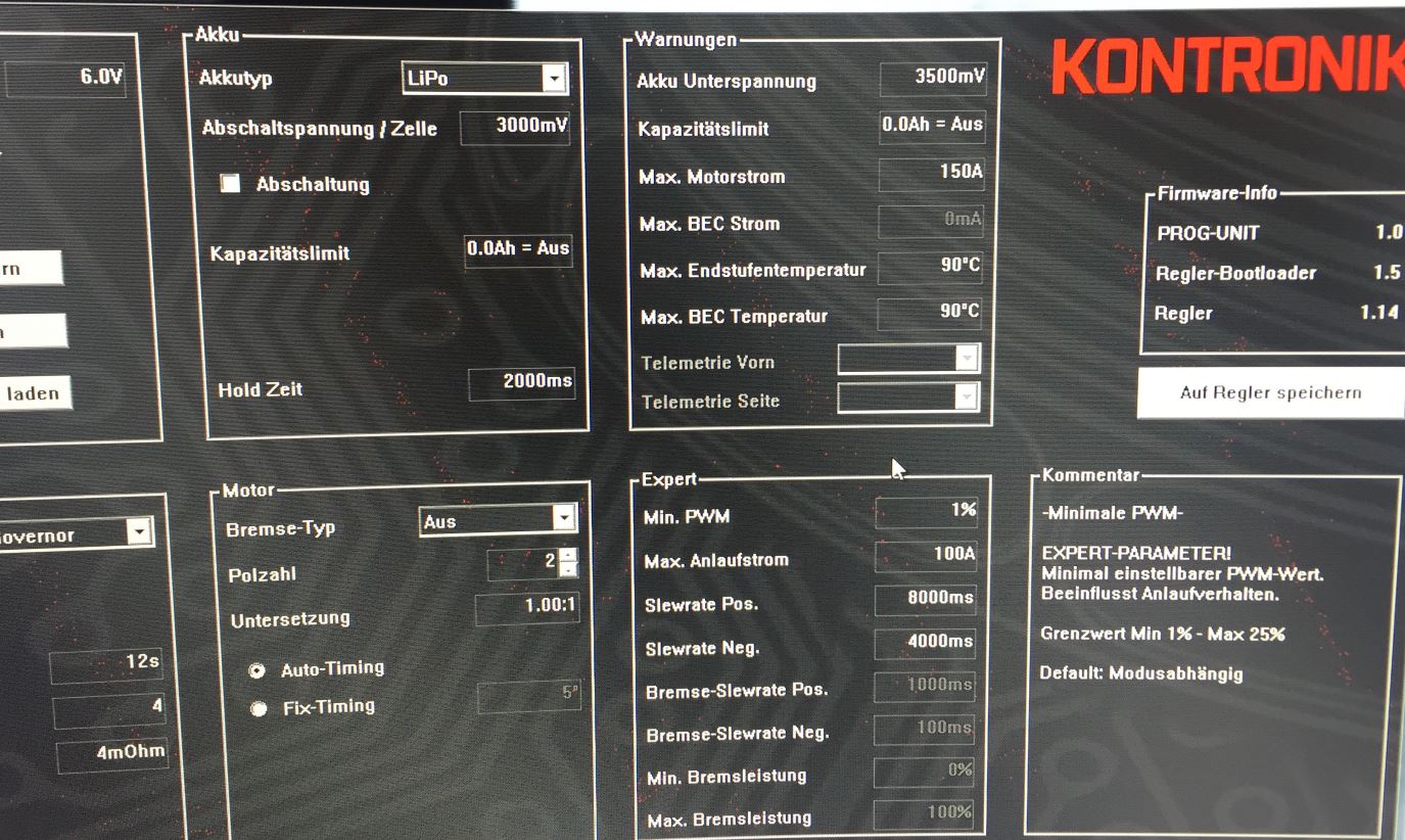

i have a issue with my Telemtry output on my Spektrum DX8G2, with airware 2.01. ESC Kontonik jive Pro120 v.1.14. Spirit Pro v2.6.1

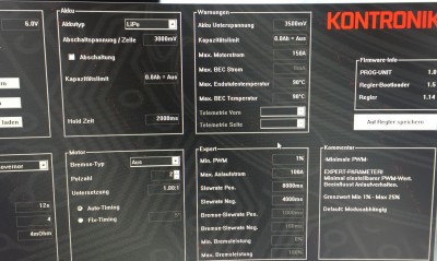

Voltage 378 V RPM 47,780. Throttle 50% is korrekt. In Spirit i set ESC Telemtry to "Kontronik & Jive Pro", and Motor settings in Spirit Software.
I use the Spektrum and ESC kabel from your Shop, and SPM4649T + 2 Spektrum SAT.
Even the motor is turnt off, there is laready showing a RPM.

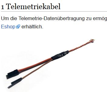

very likely you are using wrong cable or wrong ESC telemetry settings. Did you read the ESC telemetry guide?
What ESC cable you are using? There are two cables and two ESC telemetries for this ESC.

yes i was reading the manual, and i am using the Telem KONTRONIK cable from your shop.

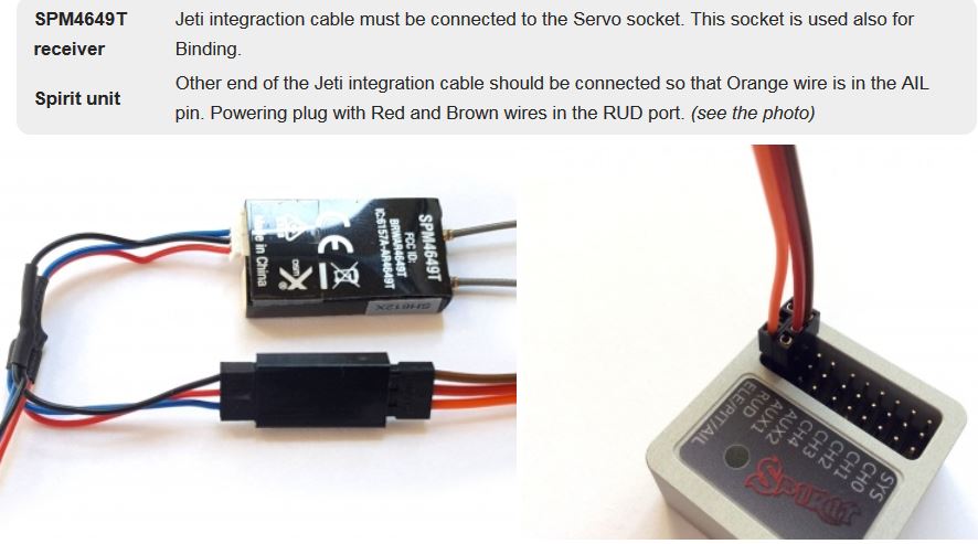

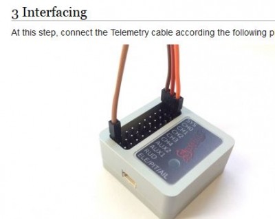

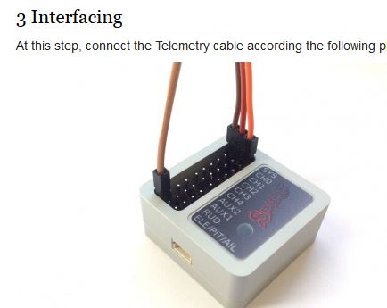

Also make sure that the single wire connector from the Kontronik telemetry cable is connected at the PIT pin. This is very important.
baccardi
Posts: 7
Joined: Tue 19. Jul 2016 8:08:06
ok to PIT ?
Posts: 13059
Sorry, the ELE pin as displayed at the photo :) The PIT pin is used for Governor.

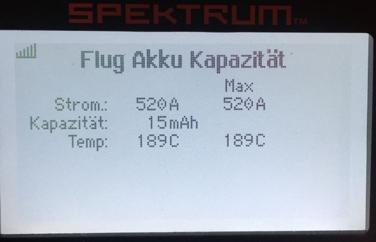

if i plug in my R² PUFFER to AUX2 i have the Problem, now i disconnect my Puffer and everything seems to be alright.
The only thing is when i got to 80% Throttle the RPM shows less then at 50%
Could the R² PUFFER be the Problem ?
