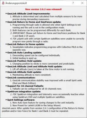

first of, thank you very much for the new release. I updated the Software (Windows) and the Firmware on my Spirit Pro.
I am using all 3 Banks of the Spirit (0=Horizontal Stabilization, 1=No Stabilization, 2=Rescue). Before Version 2.6.2 I programmed the RTH Location using my transmitter in Bank 0 and it worked for Bank 1 and Bank 2 as well. I did this for every flight.
Now, when I read the instructions for 2.6.2, I understand that I need to set the RTH Location for every Bank individually. Does this mean, when I program the RTH Location before every flight I need to do:
1) switch to Bank 0 and set RTH Location
2) switch to Bank 1 and set RTH Location
3) switch to Bank 2 and set RTH Location
Is this the right way to set the RTH Location with 2.6.2 ?
Best Regards,
Eugen

Yes this is correct you have to set the RTH point in all 3 Banks. You do NOT need to program before every flight the home point is stored until to change it. You only need to do it after the update or if you want to change the home point. Its very easy to do with the radio I have RTH programming on a separate switch. Put the model at your home point. Select bank set home point repeat for other 2 banks, only takes seconds.

We will be releasing version 2.6.3 within next week which allows to use old way for programming the points but also has the new way. Pilot can choose whether to program for all banks or only current bank directly from radio.
