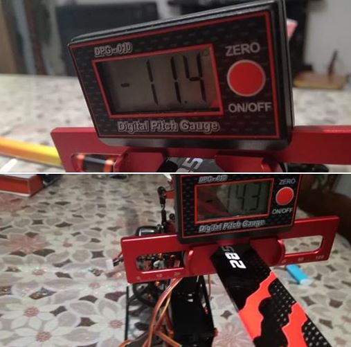

I'm making a bit of confusion in the measurements. In practice and from the photos it is possible to understand so I know, I have two different values, if I measure the pitch according to the position of the blades.in practice I want to know in which position of the blades with respect to the tube of queue measures the collective pitch and the pitch of the cyclic.
I ask this question because from the photos we see, that if I measure the collective pitch with blades at 90 with respect to the tail I have 11.4 of pitch,(min and max) if I measure with blades parallel to the tail I have another measure 14 ..min/neg and 9 max/positive.
Then I measured well again with pitch to zero of the collective, and the correct values ​​of the cyclic came out
I ask this question because to have 9-10° degrees cyclical, (I'm sure I measured it well) both with blades parallel to the tail, and at 90 degrees with the tail, and I find myself 9°-9.5° on pitch up and down ,and 10° on ale.
The problem is that to have these coherent cyclic values, I must have the value in the tab limits unit, at 150/18 °.with this last value (150/18°)I have no bindings, the servos work well
I tried to respect all the link quotas in my heli manual, and I was careful to include the 90 °servo arms in the wizard with well centered servos(with subtrim function selected).
Not if this last value(150/18°) is a sum of something is purely indicative, but what matters are the actual measured degrees with the pitch gauge

I discovered that the value ail / ele range in tab Limits(Cyclic ring tuning) is so high because it is inversely proportional to the value of the Geometry Tuning 6°.
I redone the tuning of geometry of the 6° again, (my digital pitch gauge often times of strange values), but I measured many times, and now, I find myself 6° / 120 value in geometry tuning, and 150 / 10° in tab limits ele / aile range (cyclic ring tuning)
Now everything seems to me to be coherent!

Hi Urgno , the main shaft of my heli is not perfectly perpendicular to the table, because the cart and the frame of the heli have an inclination in front, so the reference of the pitch gauge I have to take it right on the heli, in a point at 90 ° with the main shaft and not on the table.
the main problem is that my digital pitch gauge, you never give equal measurements, sometimes they are very different from each other (inconsistency) and you need to be patient. now I have found the exact 6th geometry. at least I hope..
Established the geometry value in my case 6° / n.120 value in tab setting, then everything also returns in the tab limits ele / aile cyclic range tuning value.Now i have 150 / 10°, and it seems to me correct.
I would like to know if it also happens to you that the digital pitch gauge is often wrong ...

Hi ! It happened the same to me before , I changed the battery for the digital gauge and it works fine after that.
Pino74
Posts: 192
Hello you read me in mind....I thought the same thing in fact today I have changed two cr2032 battery.now seems to go better.but in any case the display could be seen well the same even with the "old battery"
