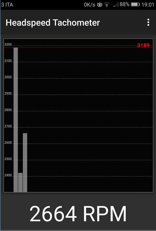

Can I know if the rpm of the telemetry with spm4649 on my DX8GEN2 are correct? I have a big doubt, in practice I set everything, wires etc, and I enabled telemetry in the spirit, but in hovering with an Oxy3 with a 60 amp HW esc , it marked me 1,200 rpm. Ever possible? What should I change again?i have flat throttle curve on my radio 70 70 70 70 70,
and I excluded the governor for now.
I made a comparison with an app on my phone, and he measures (I think correctly) in hovering at 3,200 rpm,see attachment.
So I find myself with less than 2.000 rpm on telemetry. where do I fix?

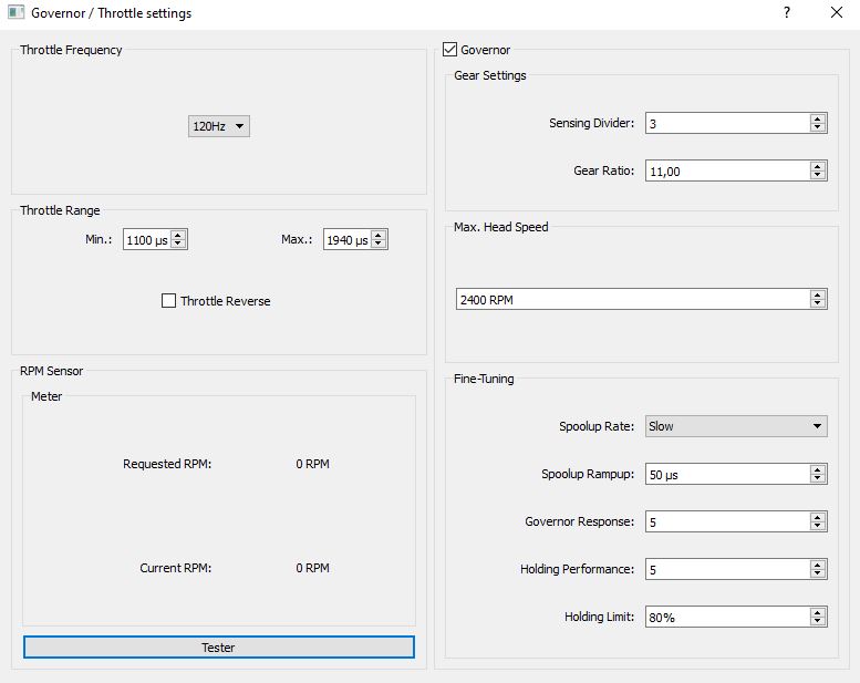

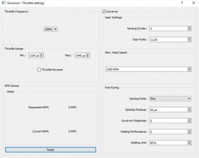

Hi Tomas, it seems that in the tab I have entered all the correct values, but I find the rpm of the telemetry not exact.
my motor is 6 poles / 2 = 3, and my pinion 11.
but the rpm works exactly only if I use the governor of the spirit? or even if it is excluded should they be exact?
Posts: 13060
Gear Ratio is not equal to your Pinion but count of the tooths of Main Gear / Pinion.
Usually this value is written somewhere in the manual.
RPM should be same with or without Governor.

My Main Gear is 140 teeth/11 my pinion is 12.727272 then=12?
i have set 12,70 value
Thanks Tomas
