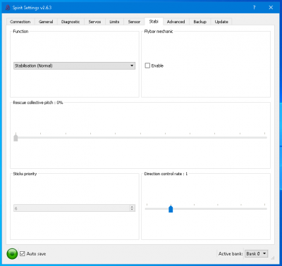

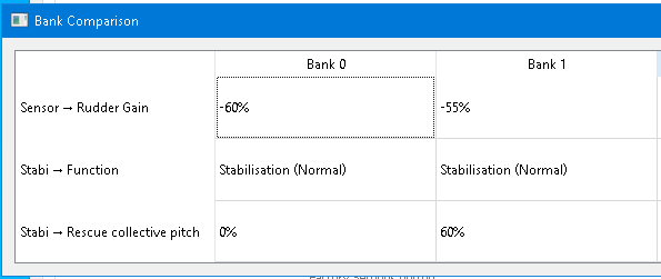

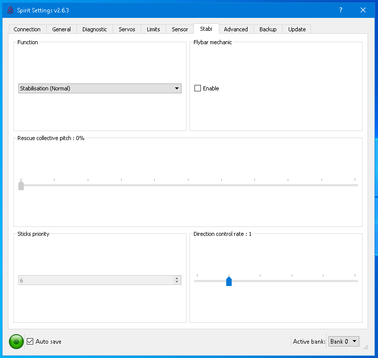

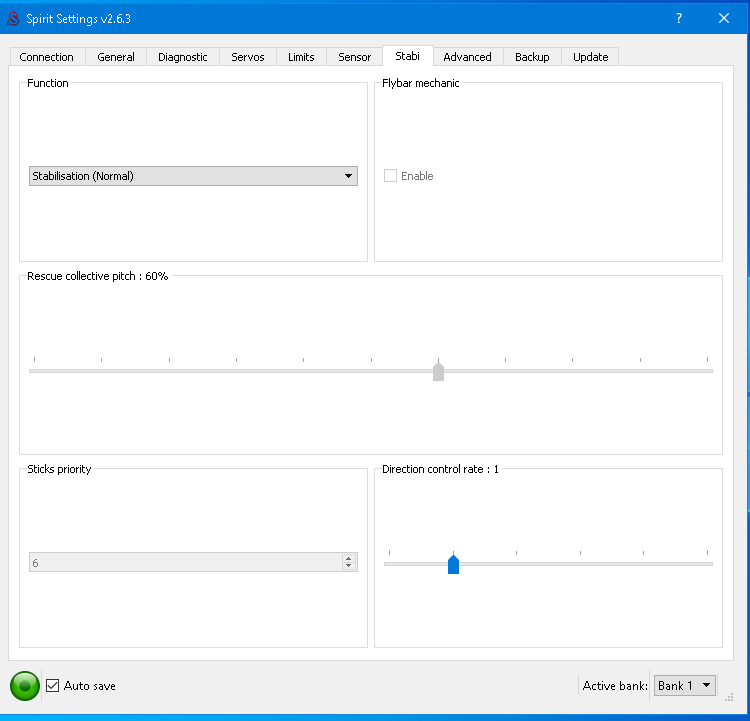

Hello
Some things in the spirit are not clear to me. In practice, I want to understand why if the % collective rescue pitch is not active in Stabilization normal mode, I keep seeing the rescue slider move when I switch from one bank to another? Is it just a notification? of the previous value when on the same bank I had the rescue activated it?but if he doesn't effect, in the "stabilization normal" mode, because I see it in the comparisons between banks? the value of% rescue only influences when this last mode is enabled or wrong?
I have included attachments

the Rescue Collective Pitch value is stored in each bank regardless of what feature is enabled. In case you would enable the value is used.
But if you are using Stabilisation it is just unused, yet still stored in the memory. So you can compare it also between Banks and see a difference just in case you would use Rescue later.
