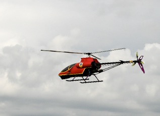

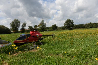

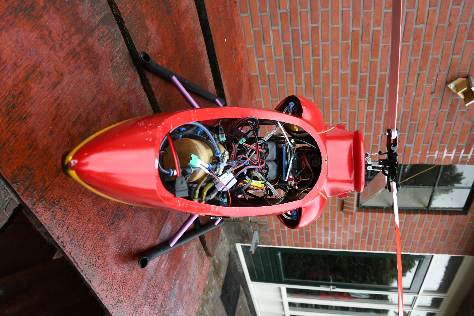

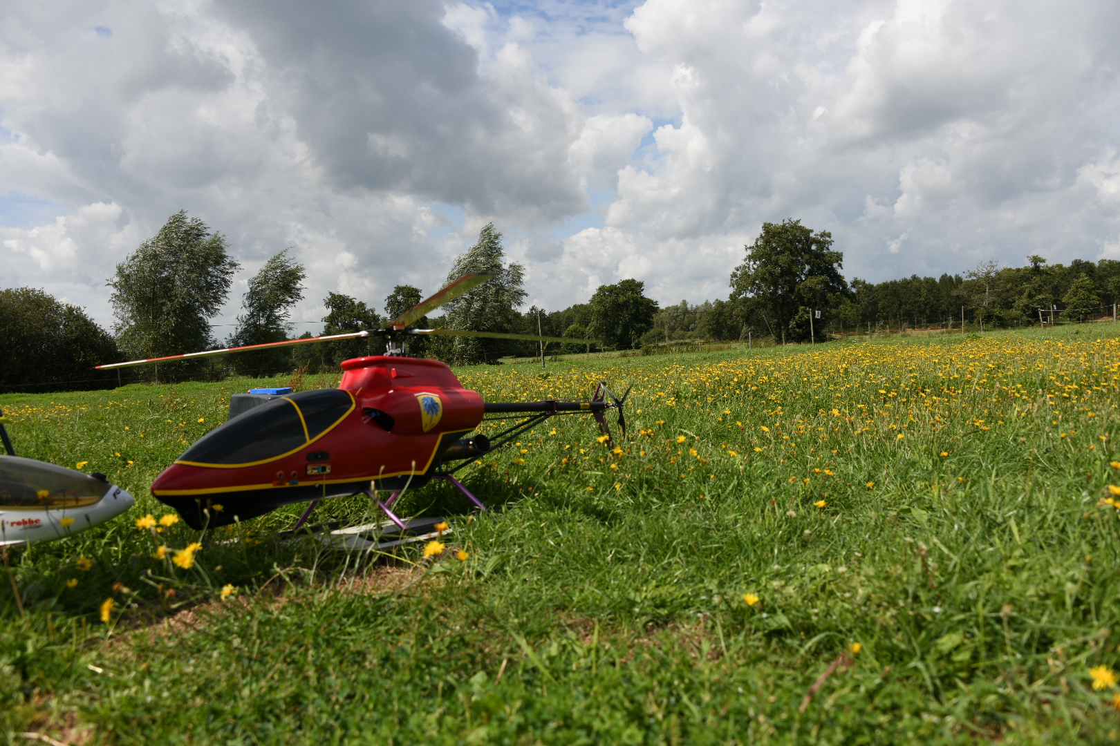

Dear,
I've started flying my Jetcat Hotcat now. Some 7 flights right now.
It's a turbine powered helicopter, 3blade PSG rotorhead, 175 cm rotordiameter, 3 blade tail rotor.
Total weight approximately 9 kg (or less), overall length 2m
Rotorspeed approximately 1180 rpm
Rotor is controlled by 4 servo's (KST BLS 815 for the rotor, BLS 805 for the tail)with a 45 degrees ofset. Rotation is counter clockwise.

Very nice machine! Thank you for sharing the photos!
