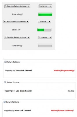

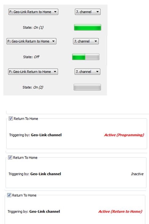

Leif
Pictures from software.

Do you get the swashplate bump when programming ?
