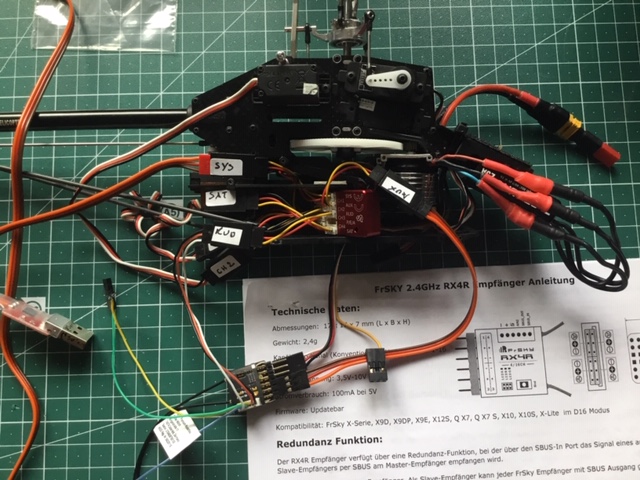

I have a T-Rex 250 heli with „Hobbywing Platinum 25A V4 3-6S Brushless Controller with BEC“,
FrSky Rx4R Receiver and the ySpirit Stabi. Board Voltage is adjusted with 7,4 Volt.
The ySpirit worked for 5-6 hours. I had connection with the USB cable i changed parameters.
I adjusted the channels.
But sometimes i got a messeage from the sender that the telemetrie connection is broken.
And after a few seconds i got the message the telemetrie connection is ok.
The wiring at that moment was this. You can see the connections on the added picture, but AUX was Not connected.
CH1 – 4 are connected with the servos.
SYS is connected with the Spirit USB cable
AUX was free
RUD was connected with +- from FrSky receiver (red/black) and with the white wire „S-Bus out“.
P/E/A was not connected
SAT was not connected
The throttle cable from the controller was connected on CH3 from the receiver.
With this wiring i got connection with the Spirit Software and with the sender i could move the servos.
So far so good.
But later i wanted to connect the programming cable from Hobbywing controller for the telemetry data
with the SAT port of the ySpirit.
And i connected the CH1 from FrSky with the AUX port oft he ySpirit for a better powersupply.
I don‘t know after which from the two connection the stabi showed no reaction, because ich had mounted
the stabi inside the heli, and i couldn’t see the status led. I recognised that i got no connection with the
Software on the SYS-Port. Then i opend the heli frame and i saw that the status led was dead.
The powersupply from the BEC is ok. Status LED on FrSky is on and the motor is running if the sender
gives the throttle signal an CH3 to the receiver.

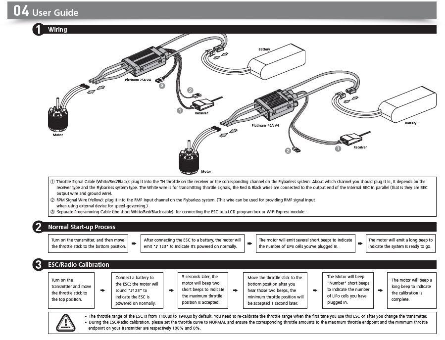

I thought it would work the same way as with spirit pro and Hobbywing 130A Controller.
There i have only connected the program port with the telemetry cable, because of the format of the SAT port connector on spirit pro.
So I connected only the program cable of the Hobbywing ESC 25A directly with the SAT port of the ySpirit.

7) I have added the manuals of HW and RX4R for better undersatnding of the pins.
