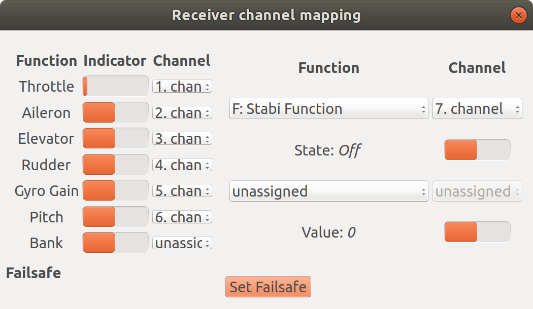

When I first setup my R-XSR, I used the Spirit's "Set Failsafe" button to set failsafe values.
Now I want to use the receiver's built in failsafe instead.
I want this so that I can set throttle to "hold" instead of pinning it to a specific value at failsafe. This is easily done with OpenTX failsafe settings but there seems to be no way to do it with spirit failsafe.
So I want the Spirit to "act dumb" about failsafe and just always use the receiver channel values.
Can I do this? If so, how?

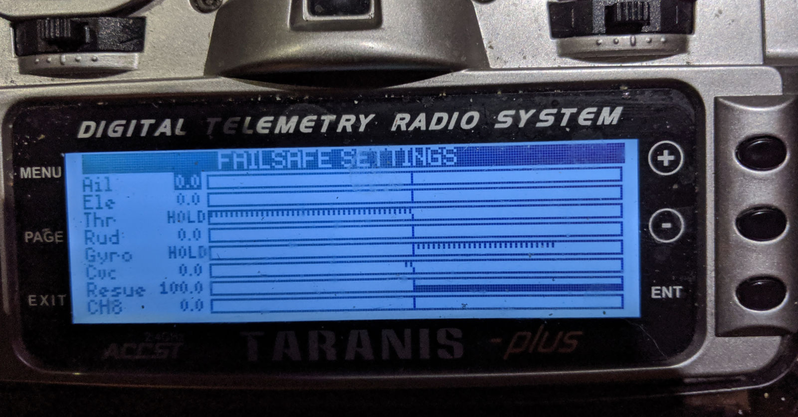

I'm pretty sure that I'm using the correct setup on the radio. It's the same one I use successfully on many other planes and helis with "simple" receivers.
The screenshot shows the setup. The most important thing is that throttle says "HOLD".
In my testing with spirit, I did the following:
- Took blades off
- Connected to spirit PC software
- Spin up heli
- Turned off the radio
This caused motor to stop. What I wanted was throttle hold (motor keeps running)
Then I tried a second experiment.
- Spin up heli
- Clicked "Set failsafe" in the spirit PC software
- Turned off radio
Now the motor keeps running. So the third experiment:
- Turn on radio
- Spin down motor
- Turn off radio
Now the motor spins up. Not what I want.
