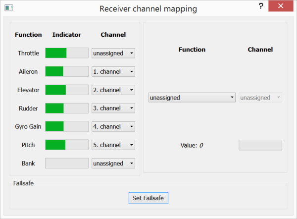

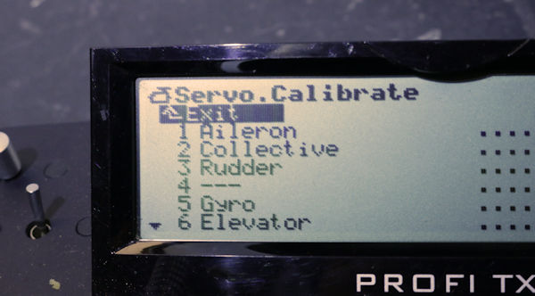

Yes, I can change the transmitter mapping, this is actually the first thing I tried, here is the TX side:
and the Spirit side:
Note that I had to skip the channel 4 on the TX, because the Spirit unit doesn't see it.
As far as I know, I cannot change any SRXL parameter: I can only choose between SRXL v1 and SRXL v2 (I tried both, V2 is worse)

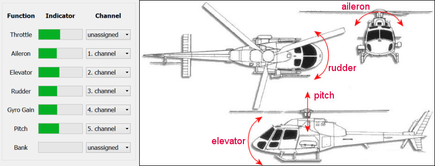

Ok, I figured it out: I got confused by Spirit's channel names "pitch" and "elevator" and inverted them, for future reference here is which is what:
I suggest that in the Spirit UI, "Pitch" is replaced with "Collective". "Pitch" is very confusing because it is also an Axis name:
