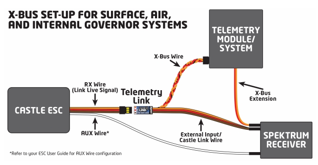

I'm perfectly happy using my computer or android app to set up and change settings on the Spirit units I have but would like to get ESC telemetry data back to my TX.
I can do that with your Integration but it adds complexity which I don't really want.
Can I use Castle Creations "Telemetry Link" with my Spirit units, without adding an actual RX to my models? With the support for SRXL2 sats now, I wonder if the Spirit unit could replace both the RX and Telemetry parts in the attached diagram?
Posts: 13059
yes, it can replace receiver and telemetry module completely.
You will only need Spirit unit, ESC, SRXL (SPM4649T) or a SRXL2 receiver.
