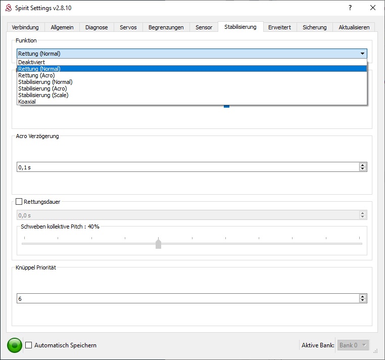

I installed the Spirit in a paddle heli, in order to only use rescue and tail stabilization. During normal flight I want the "pure paddle feeling", without any influence coming from the Spirit (except for tail).
I didn't find the settings how to achieve this, the Spirit always corrects via the swash plate.
Is it possible to "deactivate" the Spirit, but still to use the rescue function?

Do you have any kind of horizontal stabilization activated ?
BR Eugen

That might be the crucial question: how can I completely deactivate horizontal stabilization (but keep the rescue function)?
I only found how to adjust sensitivity (which cannot be adjusted to zero).
Which setting deactivates horizontal stabilization?
Thanks for your help

This should be the correct setting.
Best, Eugen
Posts: 13058
with the current firmware certain portion of stabilisation is always enabled.
But you can change settings so it will fly more naturally. Settings Rotation Speed to 9-11, Flight Style to 8 and Cyclic Feed Forward to a higher values can do the trick.
But it will be always more stable than without unit.
