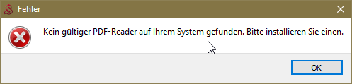

I am using the Spirit Configuration Software v3.0. When I try to open the log, I get an error message that no valid PDF-reader was found on my system.
2020-04-15 15_53_09-Fehler.png (5.7 KiB) Viewed 3024 times
The Adobe PDF viewer is installed (default folder "C:\Program Files (x86)\Adobe\Acrobat Reader DC\Reader\AcroRd32.exe"). The PDF viewer normally works fine and is setup to open .pdf files by default.
Has anybody an idea what the problem might be?

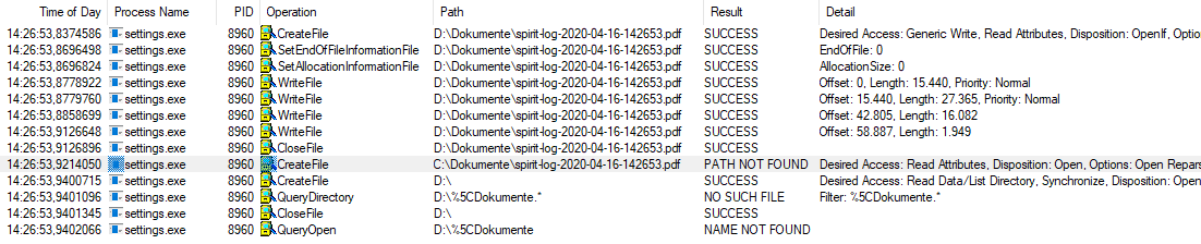

I monitored the Spirit Settings process with Procmon (SysInternals). There I can see, that the Settings tool creates a new PDF-file in my D:\Dokumente folder, but then tries to open C:\Dokumente\spirit-log-....pdf. The drive letter changes from D to C. On C the folder Dokumente and the logfile do not exist. But if I look manually into my documents folder on D, there the logfile exists and I am able to open it using the Explorer. It just does not work from the Spirit Settings tool.
