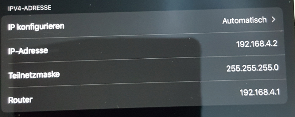

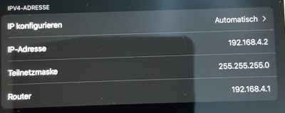

Posts: 12988
Please check if iPad is really connected to the module.
It should obtain IP Address 192.168.4.2 from DHCP.
Can you confirm this?
helimb
Posts: 23
Joined: Sat 18. Jan 2020 15:34:47
Posts: 12988
In this case it must work.
Please enter following address:
http://192.168.4.1

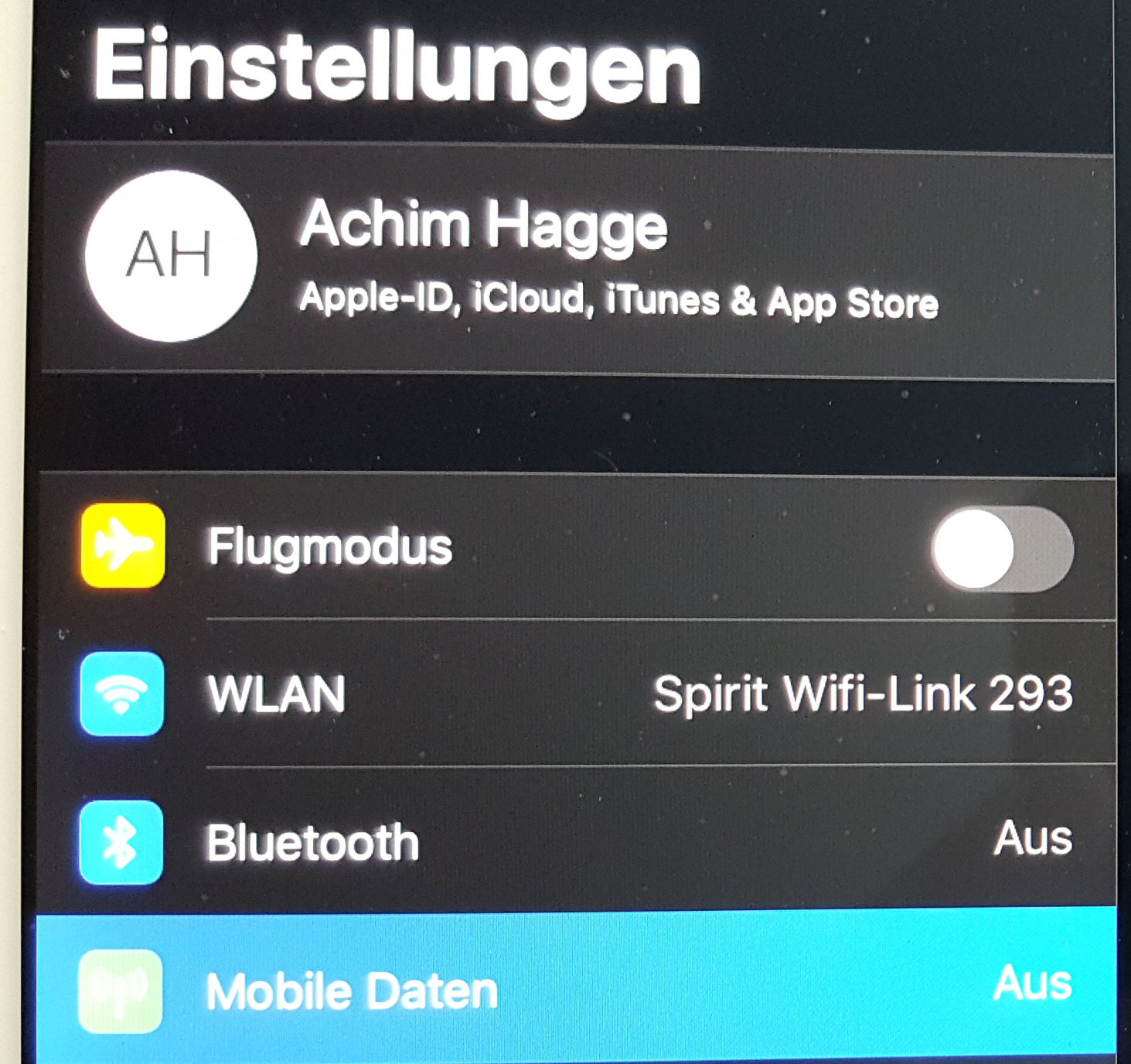

If it will not work, then try to turn off mobile data (internet)
helimb
Posts: 23
sorry Sir,
still it does't work with
switching "mobile data" to off.
