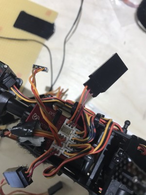

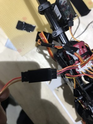

I have as ESC YGE 35 LVT , as FBL micro spirit , as RX Graupner GR16.
I would like to get telemetry data to my TX via spirit - that doesn't work. Spirit - > HOTT Integration works well. Alternatively - using ESC directly at T-Port from RX works well.
My wiring which doesn't work :
YGE - blue connector without red wire at spirit SAT connector ; on the other side wired like HOTT Integration.
When that will work - where did I get RPM signal from ? I assume as shown at documentation YGE red wire (RPM signal) must be connected to spirit's AUX1 - signal wire
please check out 2 pictures for illustrating
thanks and regards Siggi

you have to put integration cable from spirit unit and the blue plug from YGE, red cable pinned out and isolated, together in a Y cable or block and put this in the port of GR16, that you choosed for Telemetrie. There's no need to run Integration or telemetrie through the spirit unit but directly in your receiver.
So YGE gets showed as ESC and Spirit as GAM in your transmitter.
And why do you want to use RPM signal? RPM you can see in your transmitter with telemetrie and YGEs gov is working fine.
Regards Uwe

Great idea - thanks and big hands for your advise. Will try it . Siggi
scvflyer
Posts: 101
Joined: Wed 22. Jul 2015 16:02:51
Just to give everyone a feedback - it works well - as advised Siggi
